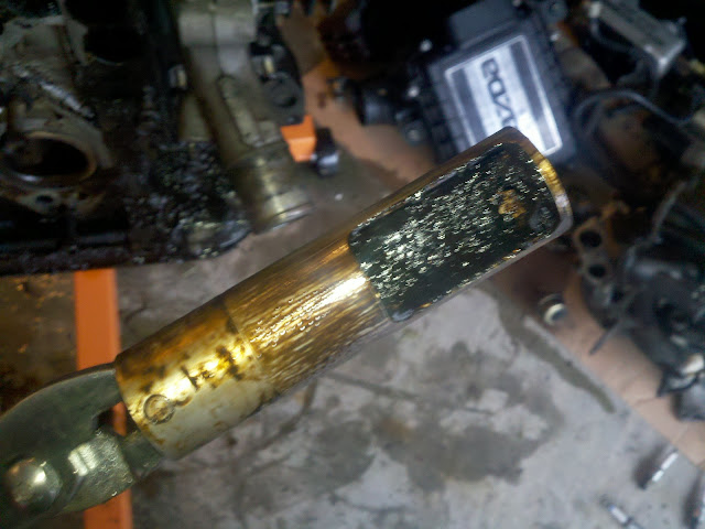

Starting pulling the engine apart and found some more interesting things. Notice all the oil buildup. I think there was something seriously wrong with the front rotor/housing/iron - this thing is nasty.
Here's a picture of the auxilliary port sleeve for the front rotor (far upper right port in the previous picture). Again, note the oil buildup.
That looks about normal for a long life engine. Maybe you should clean it more often
Yes. That however, is not normal. My thought would be that the oil from the broken feed line has weeped into the gasket and soaked through that and has been deposited over time into the back wall portion of the sleeve. Something to consider is that the same debris that caused that build up also probably went into your combustion chamber.
How does an engine coked in oil look normal?! 105k miles is also hardly what I consider a "long life engine". Hell, I've only put 5k miles on it in nearly two years of ownership. This also isn't a show car. As long as it (was) running I didn't really care how clean it was inside or out.
