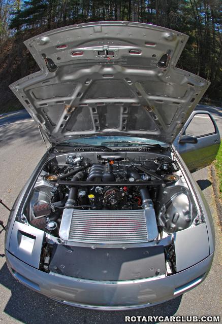

Those are stockers and I'm going back to KDR this Friday to up the boost to 15psi and look for 400 wheel. And my build thread is http://rotarycarclub.com/rotary_foru...ead.php?t=6995
