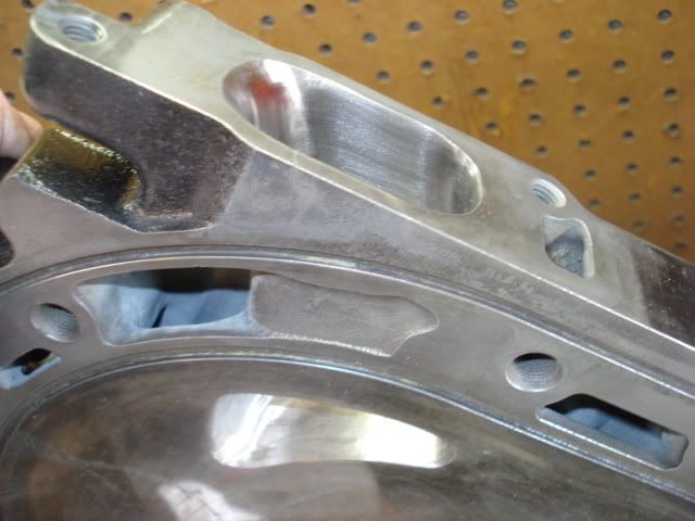

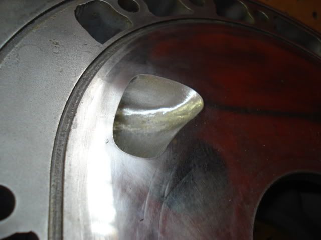

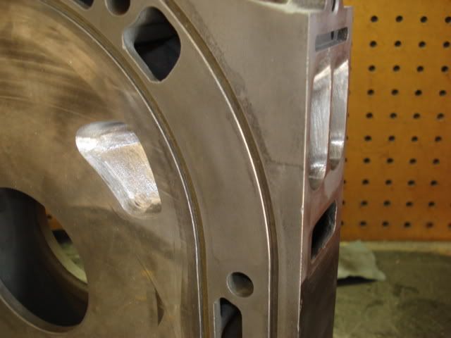

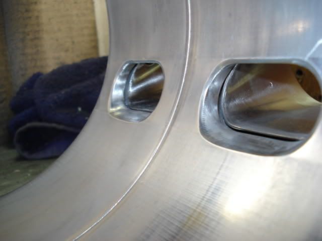

Engine Pics from David

Old 03-07-2009, 09:58 PM   #5
Damn nice porting David
