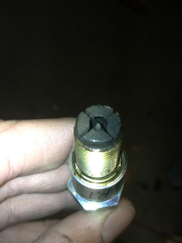

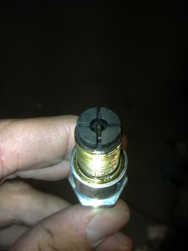

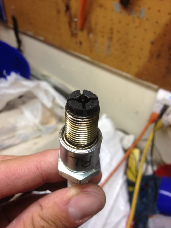

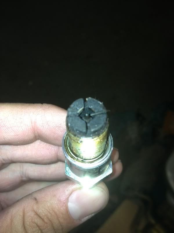

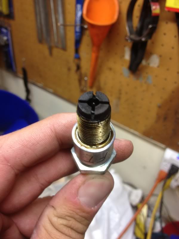

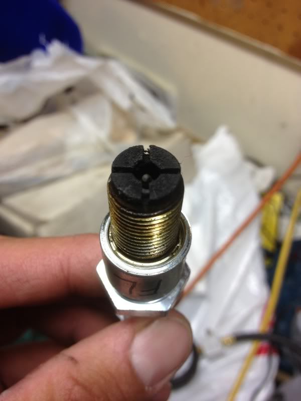

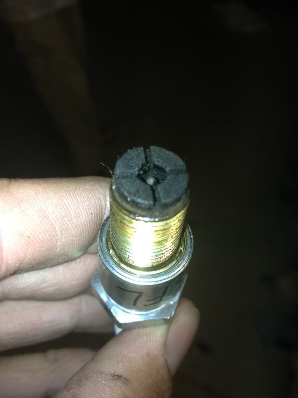

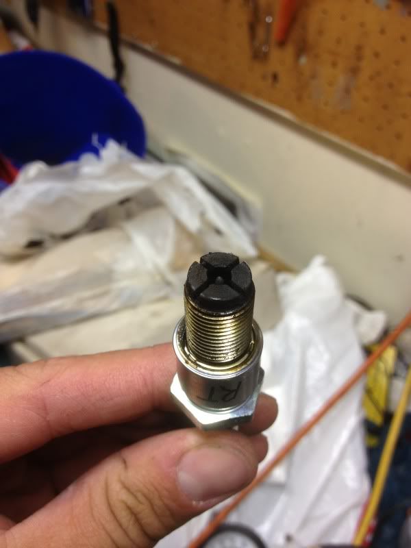

I did a cold and hot compression test, but I don't think my tester is any good. I got around 40-50psi on both the cold and hot compression tests, but the car started tonight and I don't think it would even run if it was that low on compression.
When I took the plugs out, THAT is when I noticed a problem. And I feel like an idiot for not thinking of it before. I don't remember when I put these plugs in but they were toast! Here are the pics...
Front Trailing...
Front Leading...
Rear Trailing...
Rear Leading...
As you can probably tell, the front leading was the worst one. All of them were worn down to a point but that one was worn down about half way. After I swapped the new plugs in, I didn't have as much of a problem starting it, albeit it wasn't as easy as it should have been.

jeebus, those plugs must have had about 20k+ on them. you should really pay more attention to the tune up items on a car pushing that sort of boost level.
i would try to get the engine compression tested to verify how healthy it really is still.

Yeah I can't believe I hadn't thought of that before. It seemed like I just replaced them so it didn't cross my mind. I'm going to keep track of it now though. I'm documenting the mileage so I can see if I have other issues that are wearing out the plugs faster. I'm still going to compression test.
