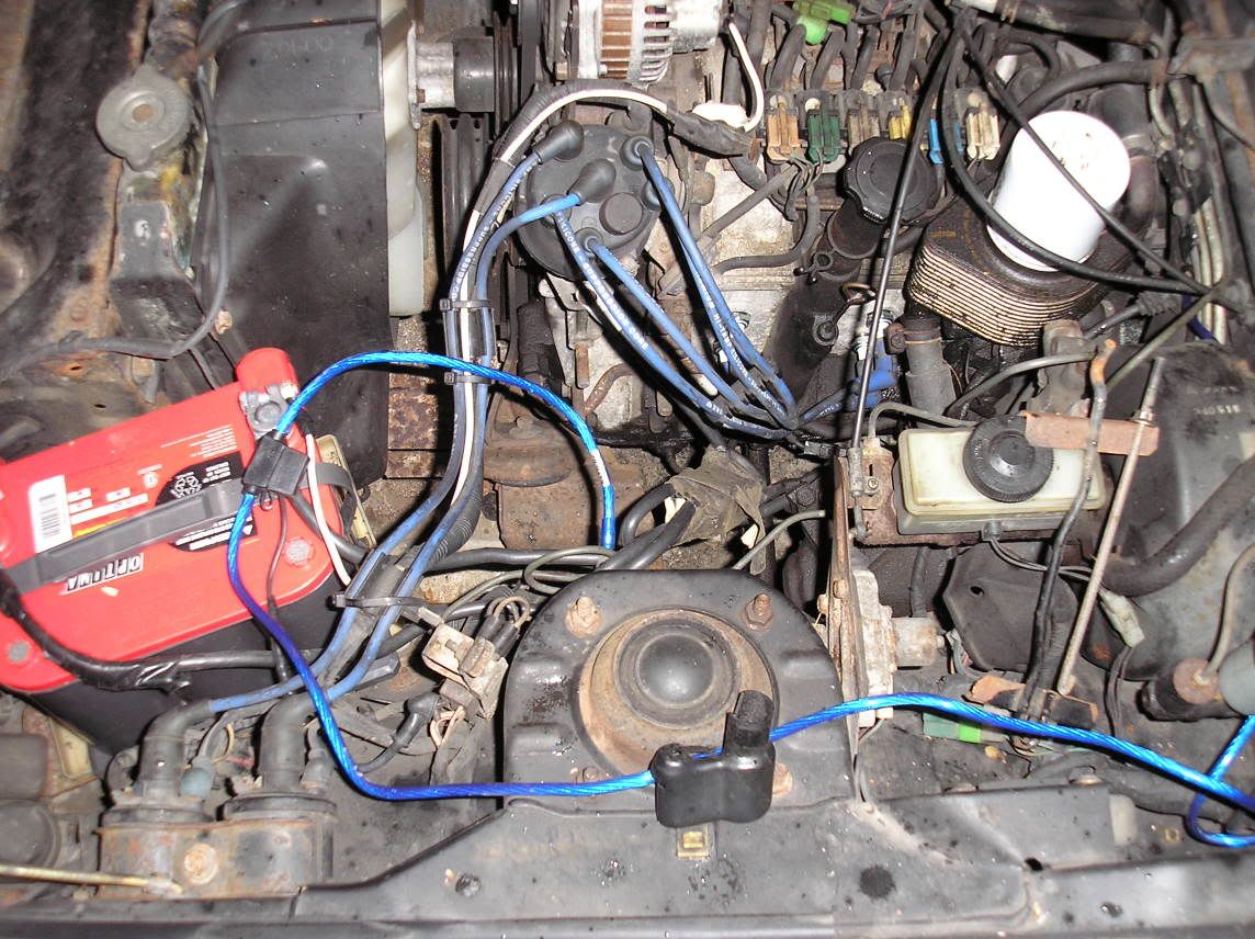

BTW, do you have a digital camera? Take some pics of what you've got, and we can look here and try to help you diagnose it now.
Here's a pic of my FB from a while back, this is what it should look like:
