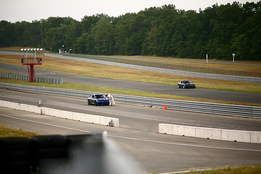

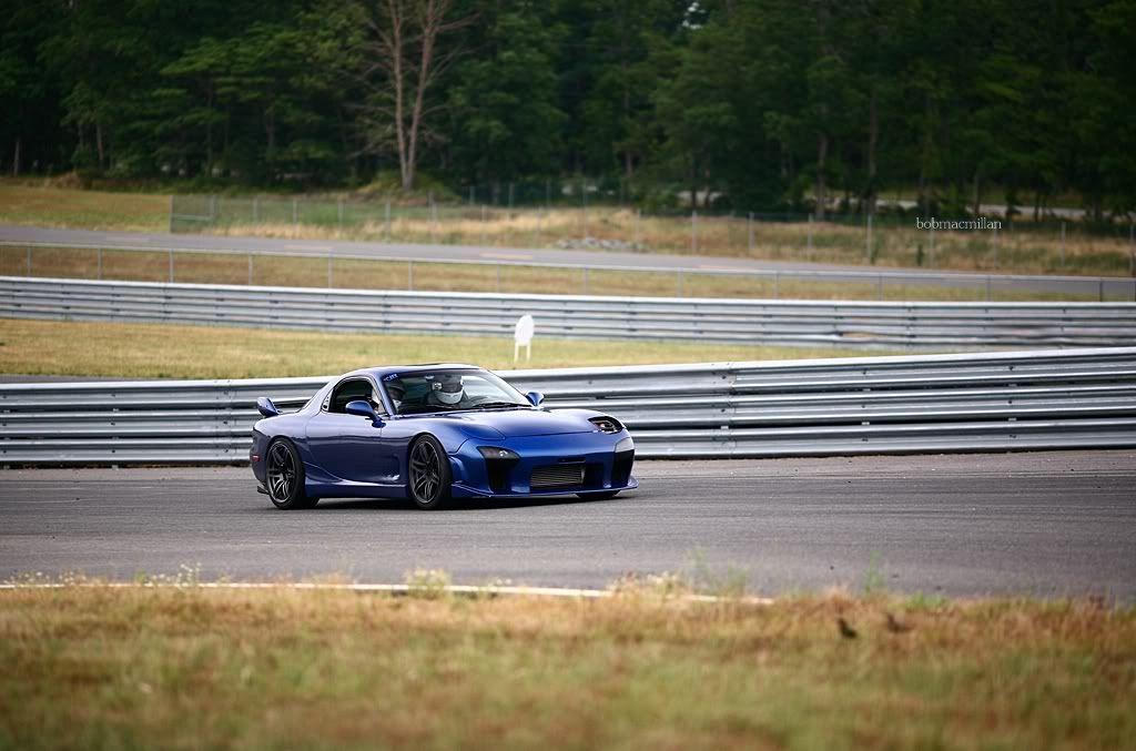

I came across some more shots a fellow photog buddy of mine took at one of the events this past summer.
This new bumper was LONG overdue...
This is me getting black flagged because the corner worker thought my hood was popped... it was just large panel gap
That same day I also lost my driver side headlight cover at the end of the front straight from air getting under the cover... once again from a poor fitting bumper

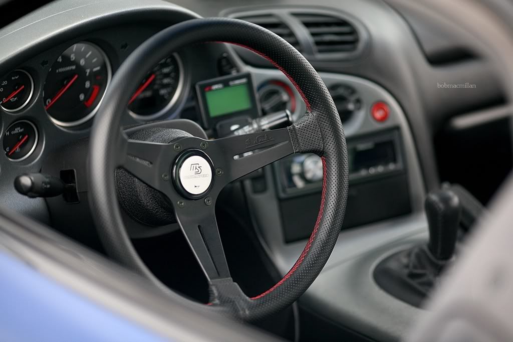

And a random shot of my interior from the same photographer.

Is that grey on the interior panels similar to the Spirit R pieces? Is it somewhat rubbery like in the Spirit R? I've been wanting to do that for a while now. It looks REALLY good.
It is just the 94 finish plastics painted gunmetal grey. I did this back in my "ricer" days back when other people were painting their plastics the color of their cars and whatnot. Im just glad I picked a color I still like, because there is no going back. At the time I was unaware the Spirit R had a grey dash.

Oh ok cool haha. I'm surprised the paint has held up so well all this time then. Now I can see the texture of the 94/95 dash. Thanks!
