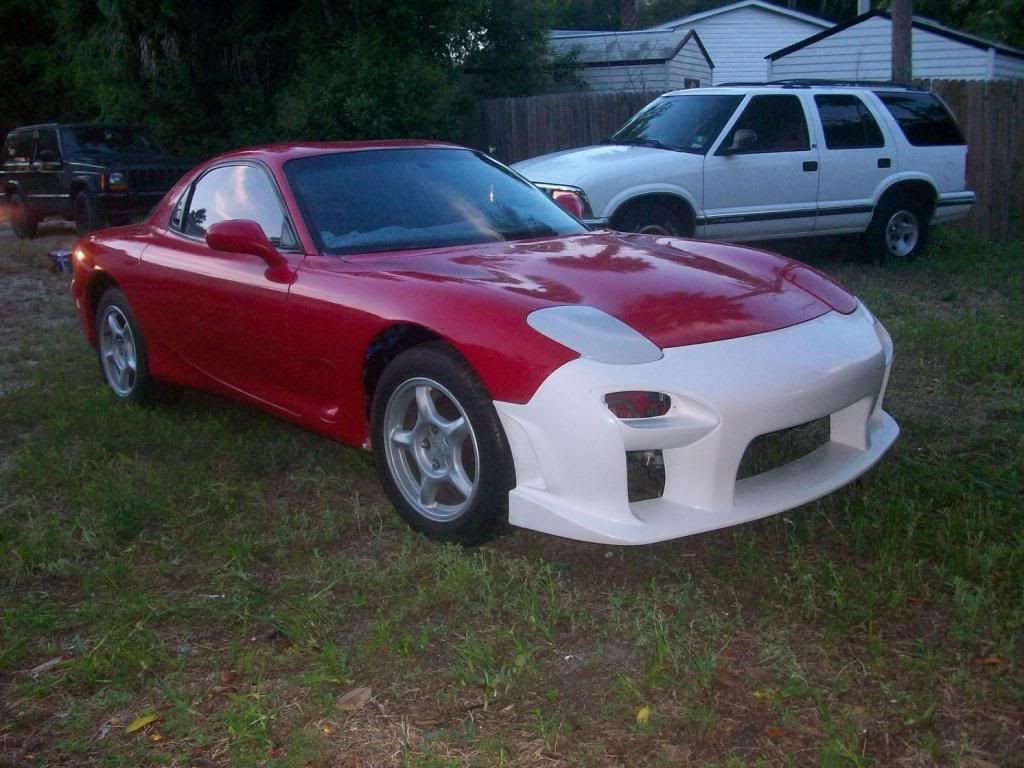

First item on the list will be the front bumper. I have decided on the Pettit GTC replica. From everyone I have talked to and all the pictures I have seen it fits close to perfect. It is really my only option considering the amount I am willing to spend on this. This will be ordered shortly as they are made to order and could take up to a month to get.
Pettit fitment:

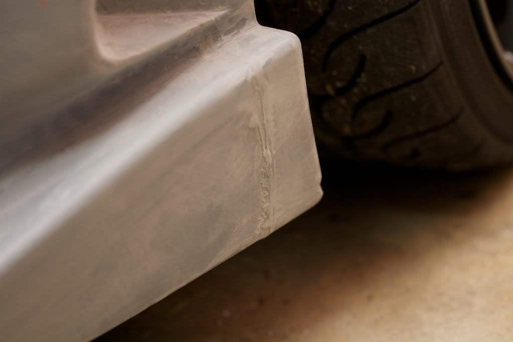

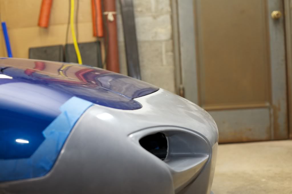

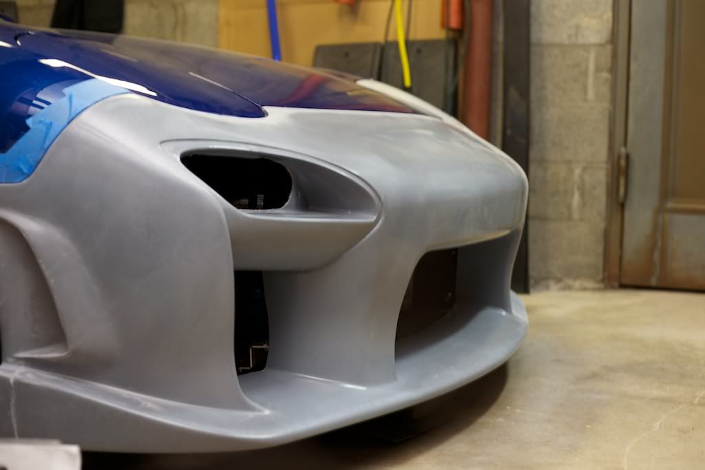

The Pettit GTC replica bumper arrived and I had some time to test fit it while I was home over the holidays. Good news is it fits perfectly!
My only complaint is that the bumper came "unfinished" with mold markings and various imperfections in the gel coat. Im going to smooth these all out before it goes to paint.

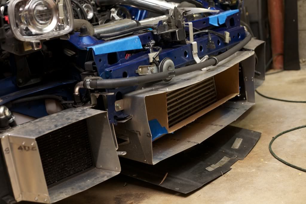

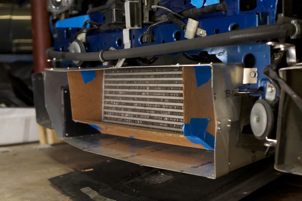

I also took some time to finally mock up a template for the intercooler splitter. I ran all last year without any ducting to the intercooler core and it worked ok, but with this Im hoping it will help maintain lower AIT's during longer track sessions.
I need to order some wire mesh for the bumper openings.
