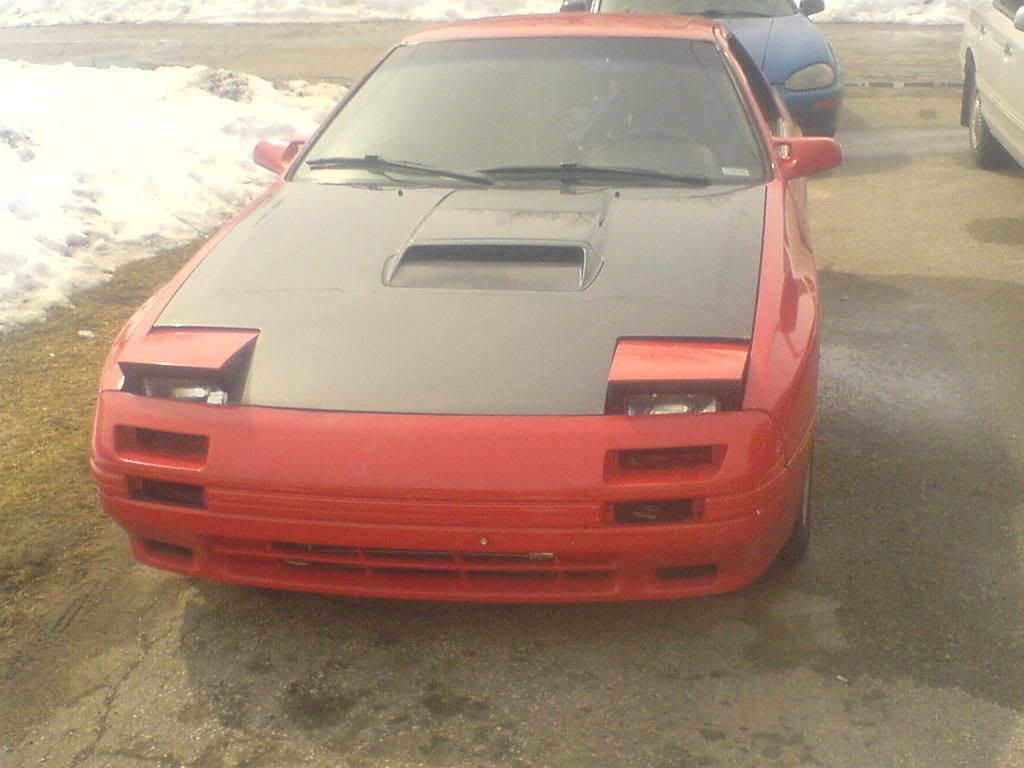

I started with a 1987 RX-7 TurboII Chassis with original 140k kms on it, the body is solid, there’s no rust whatsoever on it, although it was pretty dirty under the hood, and the red hood ended up getting damaged so it has a black TII hood on it right now. Here are some pictures of the car when I first got it.
