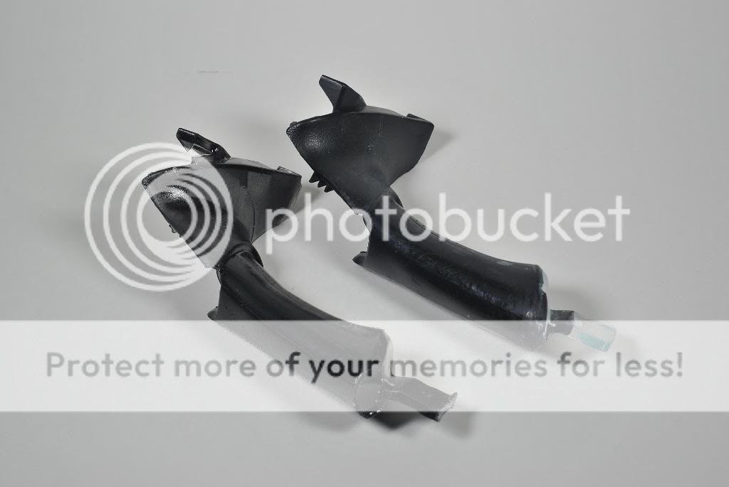

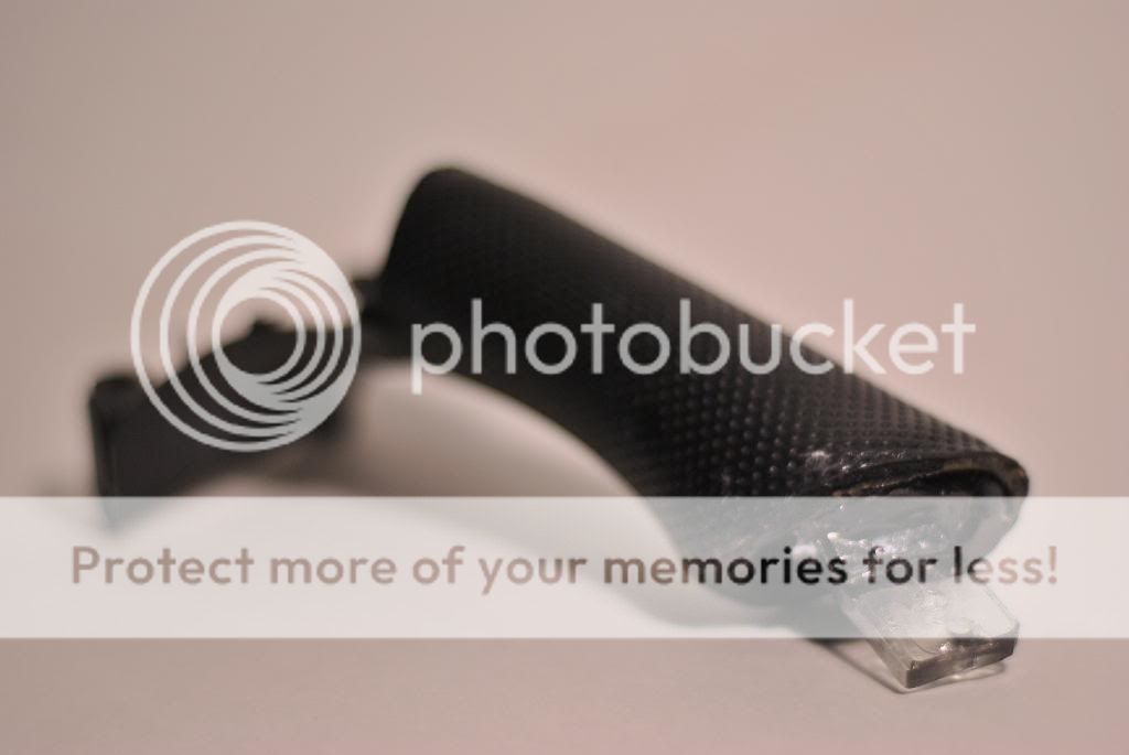

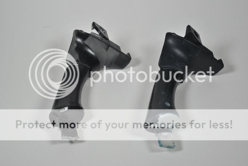

When I first bought the car my handle was actually broken. To remedy this issue, I just fiberglassed it solid to the trim piece. So to begin Prototyping an improved piece, I had to order a new one. I went cheap and bought one that was broken. So the first step was to repair the handle. The clear part is the added "cast" I did to fix the "missing/broken tab."

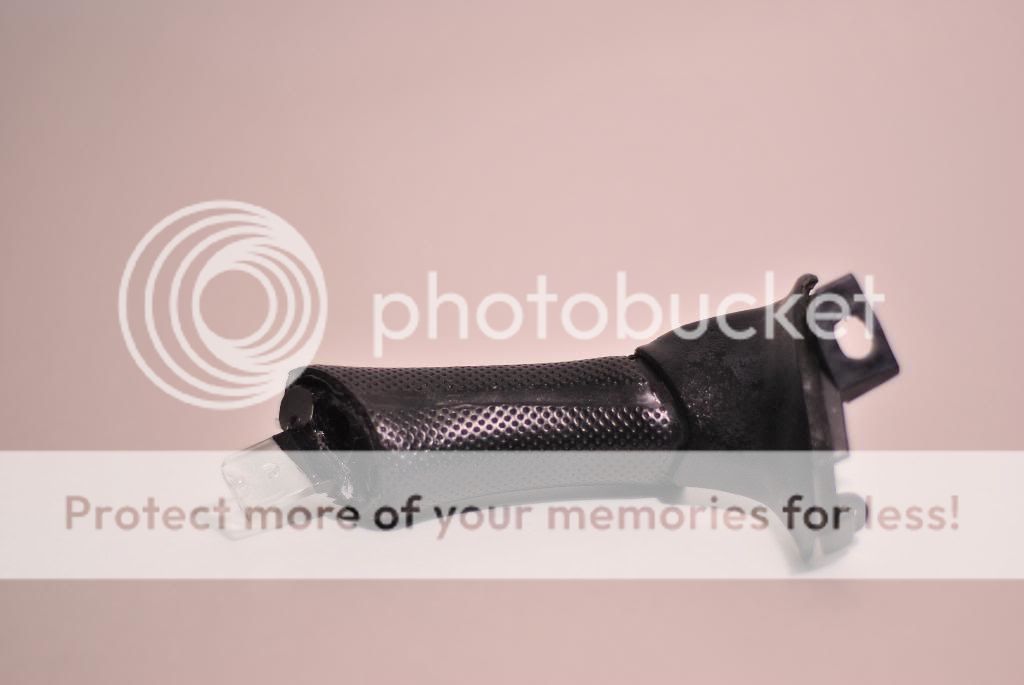

Next step I stripped the cheap tacky "vinyl?" handle cover and prepped the handle to cast the mold. A little body filler and some sanding did the trick. The first modification I did was fill in the voids under the tabs with body filler. In the new piece, this will translate to a stiffer and more robust tab support. This also gets rid of 2 undercuts to ease the casting process.

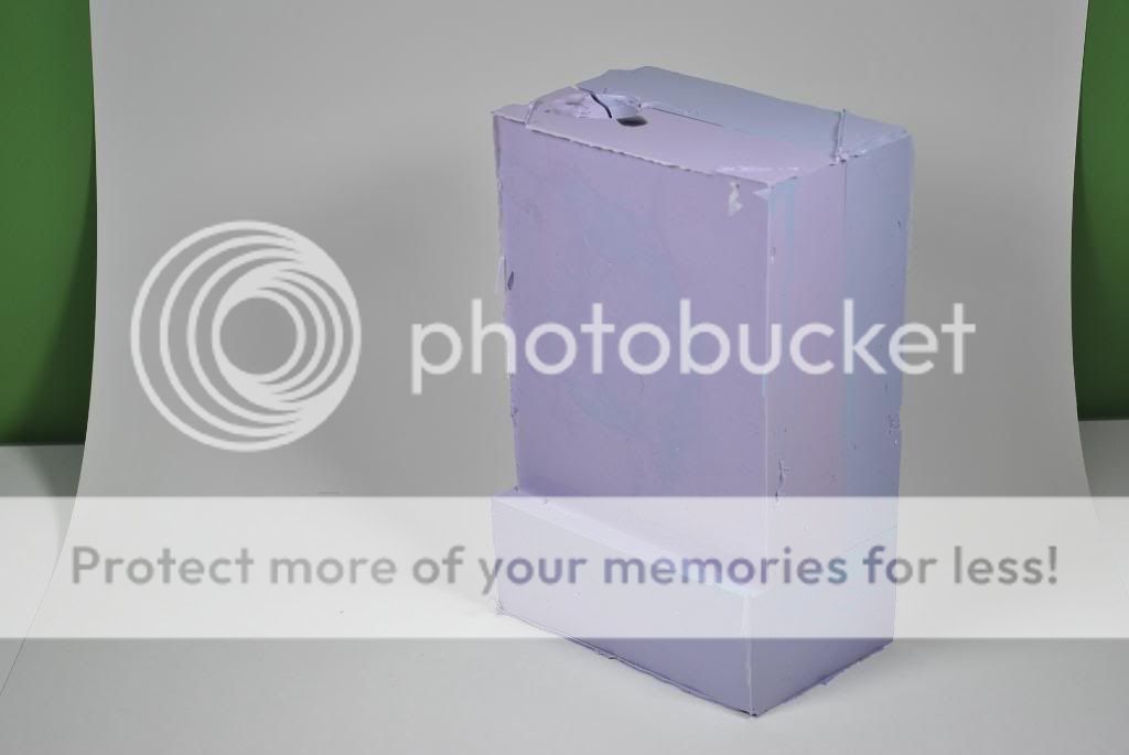

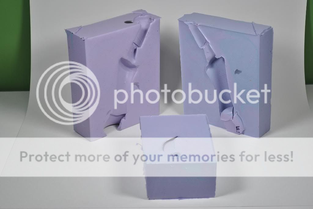

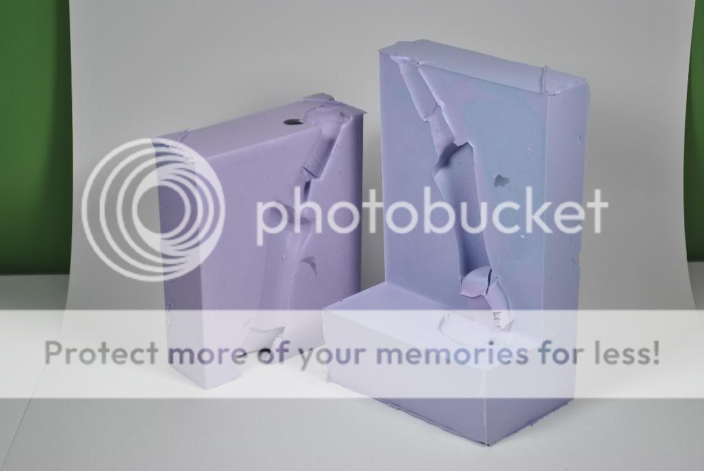

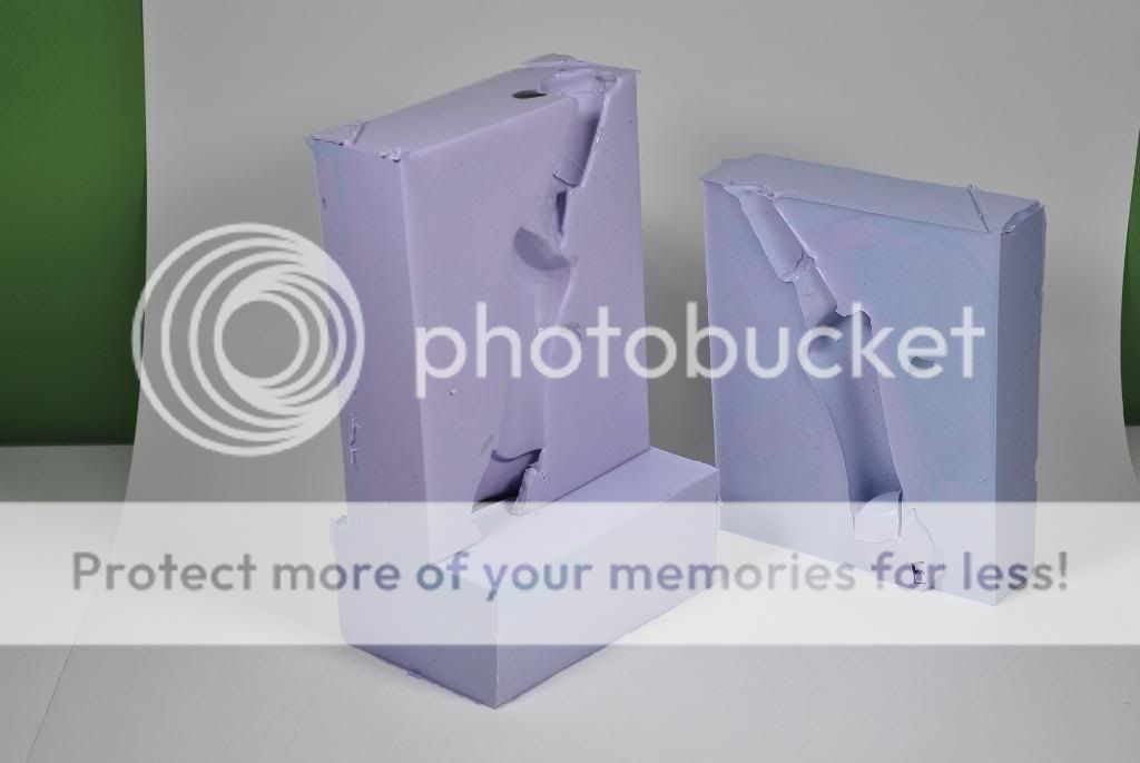

After I had a " rough sketch model" plug, I began to cast the mold. Even though there were a few imperfections and known adjustments, this was simply a test to see if I could successfully cast a new piece due to its complexity and undercuts) To compensate for some of the under cuts, I ended up going with a 3 piece mold
opposite view

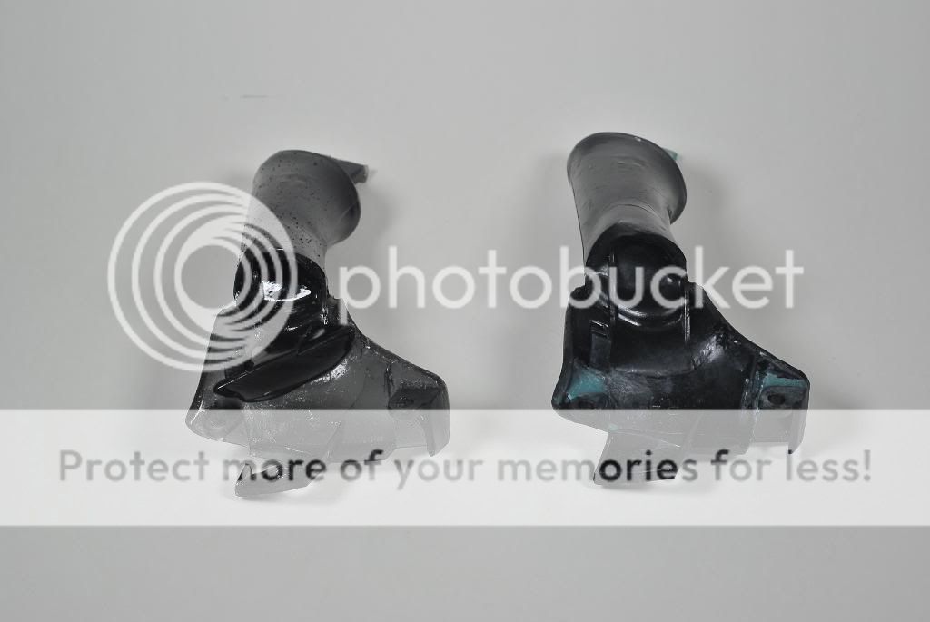

I made a few cast and shortly found out some flaws. I had found some trapped air bubbles and errors in the mold itself. I drilled an hole for one air bubble to vent and the other one was solves by angling the mold when I poured the cast. some pics of the first revision with flaws.
Also im using a Clear resin that is suppose to be for artistic purposes so the next step is looking for a more durable resin. (The black color is from a pigment dye)

Problem: As you can see in the last picture, the corner by the big tab is missing. This is because of the mold and the pouring point. This creates an air pocket and doesnt allow the resin to flow into that area.
Solution: I drilled a small hole through the mold to create a air pocket, this should allow the air to escape and the resin to flow in.
Problem: As seen in the last picture is one of the thin wall tabs towards the top of the handle. Indeed another air pocket.
Solution: Shake/have mold angled when initially pouring resin. This will cause the resin to settle in the corner while letting air bubbles out. Once I feel its shaken/leveled, continue to pour. (this has been tested and worked successfully)
Problem: There are little tiny bumps on the handle itself. This is caused by air bubbles in the mold because of the way i made the casting.
Solution: Although it wasn't intentional, I may leave it. Because the handle will be treated with a leather wrap, it will give the leather more to grab on and adhere to. If I do decide to get rid of them, it is a simple fix by reconfiguring the casting order/pattern.
Problem: The thin wall at the top of the handle has an obvious cast line.
Solution: Reconfigure the Casting line.
Problem: Tabs still have some flexibility. This could be a possible problem, but more testing will need to be done.
Solution: I still want to add more material to eliminate uneccessary undercuts as well as strengthen the tabs base. This will make a stronger post for the mounting tabs, make it easier to cast, and more rigid (not sure if thats a pro or con yet) In addition, different types of resin still need to be tested to find the right properties, shore hardness, tensile strength etc, etc, etc!
