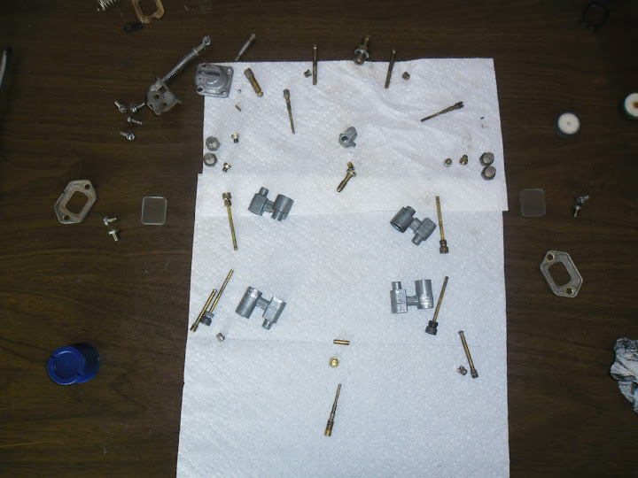

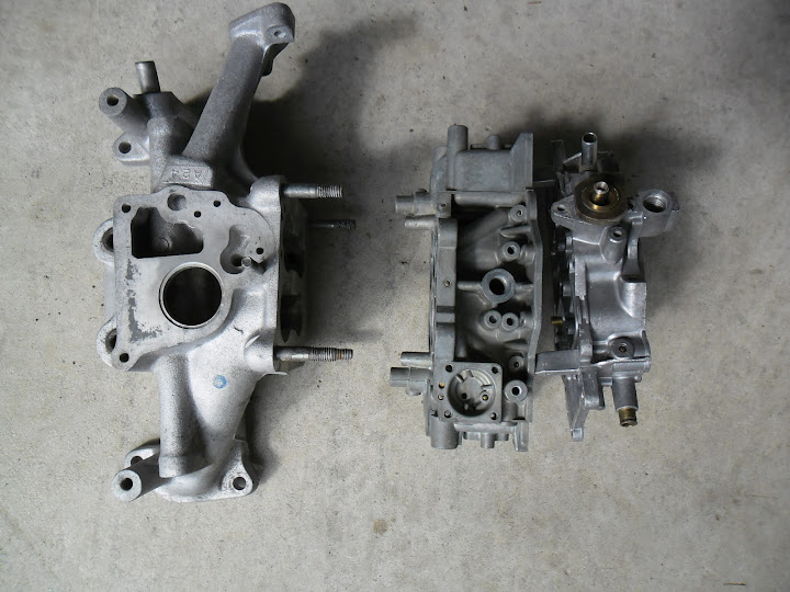

Clean up pic
Heres some pics of the intake, main body and air horn after cleaning it up
using the homemade soda blaster.
And these are all the small parts cleaned and ready for assembly.

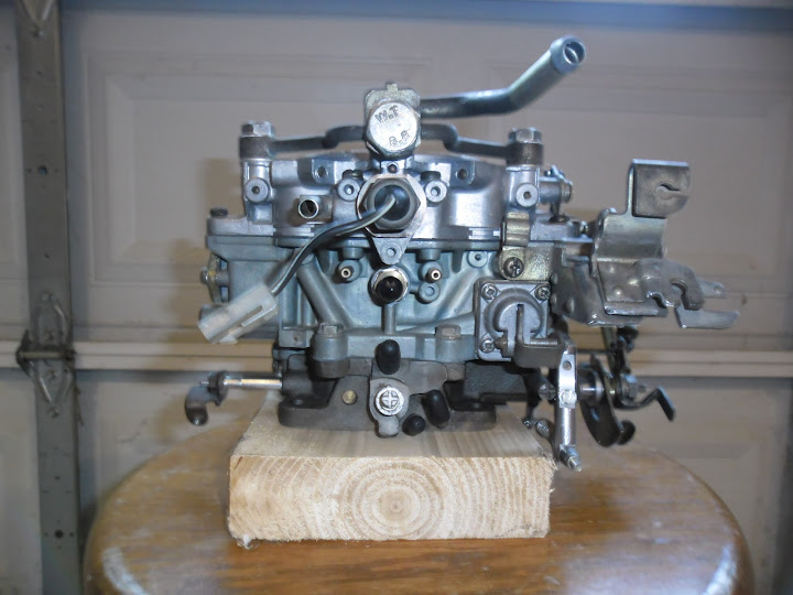

Completed carb pic
Got the carb all back together. Redid the throttle linkage to put the fast idle
linkage in. Also add the extra gaskets to the AP diaphram and extended the
AP lever arm. Bench adjusted everything as well.
Heres the front view (drivers side) of the assembled carb.

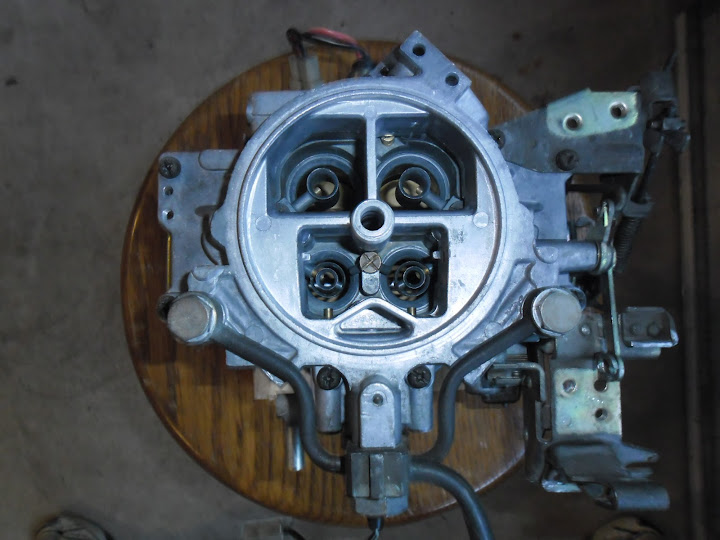

Some detail on the linkage. Pics like this helped me when I was trying to get
this setup correcly.
A top view showing the steamlined booster venturis and all.
