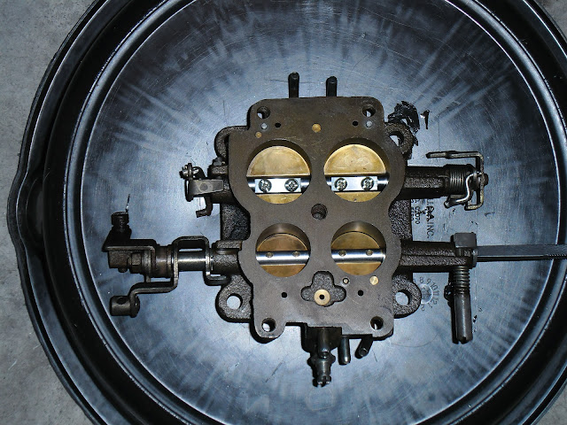

Update for pics
Heres some pics of the carb partially dissassembled and after hitting it with some lacquer
thinner to clean it up. I haven't done any other cleaning yet. I plan on using a home
made soda blaster with my compressor to do the final cleanup. That will be a lot of
fun! This carb was really easy to pull apart. Can't tell if its ever been opened before
but it seems pretty unmolested. I'd call it a good buy from pull-a-part so far.
So heres the pictures, top and bottom view of each component from the top of
the carb down to the intake manifold.
Already remove the choke assembly and few other bits.

I channeled the intake manifold and just have to plug up a hole where the
rod for the butterfly come through. I also clean up the intake a bit but I want
to media blast it before final assemply. I may clear coat it to keep it nice looking.
Did some work on the throttle cable bracket and removed some things to simplify
it a lot. No pic of that yet.
Worked on the throttle body but had a hard time getting the secondary butterfly
screws out. I tried heat and that didn't help, so I'm soaking in PB blaster and
will give it a go later this week. Any tips on removing those screws would be
great. Hate to have to drill em out.
Also worked on the carb body some. I trimmed the arms off of the primary and
secondary venturis and polished them a bit. Also ground down and polished
the chokes as well. Didn't ream them too much but I may do some more later.
I haven't shortened the oil inject tubes but I did pull them out a bit as they
were almost right up against the small center venturis in the primaries.

For the butterfly screws:
#1. Use a screw driver that is the right size.
#2. Place the screw driver on the screw and give the screw driver a good tap with a hammer. This not only sets it in the screw head but also give the threads a little shock to knock them loose. You may have to repeat this a few times, but I've had 100% success with this.
I automatically do this for all the carb screws just to make sure I don't strip any, works like a charm.
