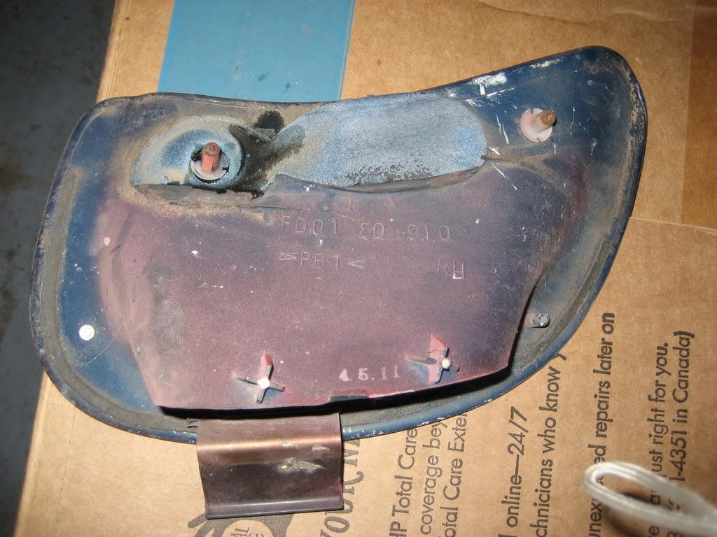

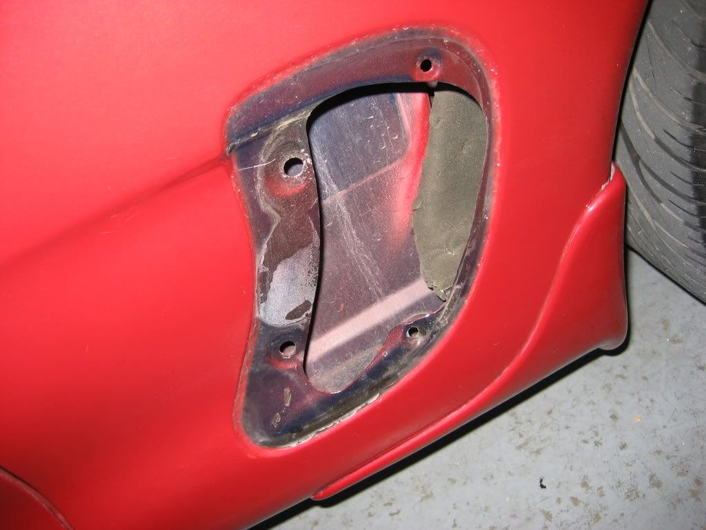

Here you go:

The big clip faces to front. Plastic clips can/do break. I pulled mine off (back and out), but did break at least one
