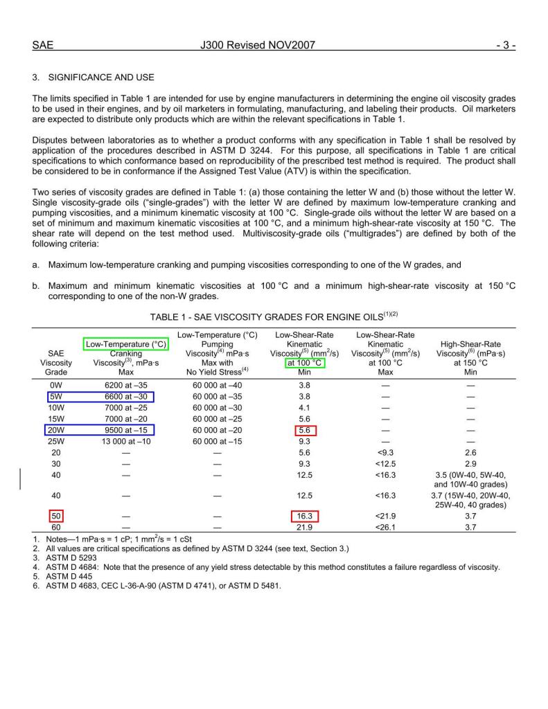

5w30 is to thin for a rotary even a NA rotary.
What oil should I use in the FC?
According to Mazda:
In starting and operating temperatures below 20F, use 5W30
In starting and operating temperatures between 0F and 80F, use 10W30.
In starting and operating temperatures above 30F, use 20W50

Depending on where you live, I doubt you'll need a 5w30. I daily drove my FC with 20w50 in TN during the winter with starting temps around 0.

As for ZDDP, it's a good think, unless you're running a catalytic converter. Those additives are very effective in wear prevention for metal parts that slide against each other. Solid lifters in a piston motor are generally the most common reference, but there is lots of metal on metal movement in a rotary. Because of this I've switched to recommending off-road "race" oils for all engines not using cats. For years we used and recommended diesel oils, because they still contained a higher percentage of ZDDP than other on-road oils. However, diesels oils have long ago been stripped of the additives as well.

so to conclude from all my reading in a 70 degree environment 10w 30 race oil would be the best choice.but i would still like to know about the elf/total brand oil.

You dont need a degree is arse sex to know that the physically thinner an oil, the more metal to metal contact there is!
Mobil 1 5W-50 is a great oil to use in a Rotary, stay away from the "thinner grades" as promoted by our Ferrari Chat Dr cock wash BDC & HC styled posting rant.

Rice: everything I've ever read on the subject written by actual engineers more or less agrees with the FerrariChat article. It's just that Dr. Haas explains it better than most, which is why I like to post that particular article. Care to provide a more convincing argument than just juvenile name-calling?

Unlike Ferrari chat Dr Nobody, I actually build and rebuild my own engines and have seen what "light weight oil" does to them long term.
You just need to ask yourself this question, why does a Ferrari Engineer specify 10x-60 for a Ferrari Enzo as listed in his "article".
Less shear plane loading through low viscosity of course will lower oil temperature, it will also greatly increase oil consumption (ever seen a F1 smoke show, or wonder why they consume 6lt! of oil in a 200 mile race!!!!), it also vastly reduces the oil wedge separating steel and white metal, send any oil in for an analysis and you will want to punch Dr Nobody Ferrari chat in the face for his SHIT HOUSE ADVICE styled BDC & HC rant waste of finger typing prowess.
I don't think i have ever seen 5w-50 state side
Originally Posted by Raksj04 View Post
Is Mobil 1 going to hurt my Oil injectors?
No it wont hurt your oil injectors it was actually recommended by MazdaComp USA to use synthetic.
I personally don't use synthetic because i change my oil so often (1500 miles or less) it wouldn't be worth the money. If i was driving in a harsh environment, drag racing a lot, endurance race i'd go synthetic.
