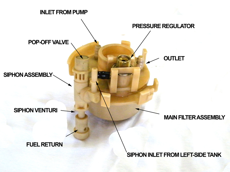

The spring-loaded upper section which has the discharge fitting and external connector, the lower fuel "bowl", which accumulates and retains fuel prior to being picked up by the pump, the pressurized main filter and integral fuel pressure regulator, the regulator discharge and siphon assembly and the pump motor itself.

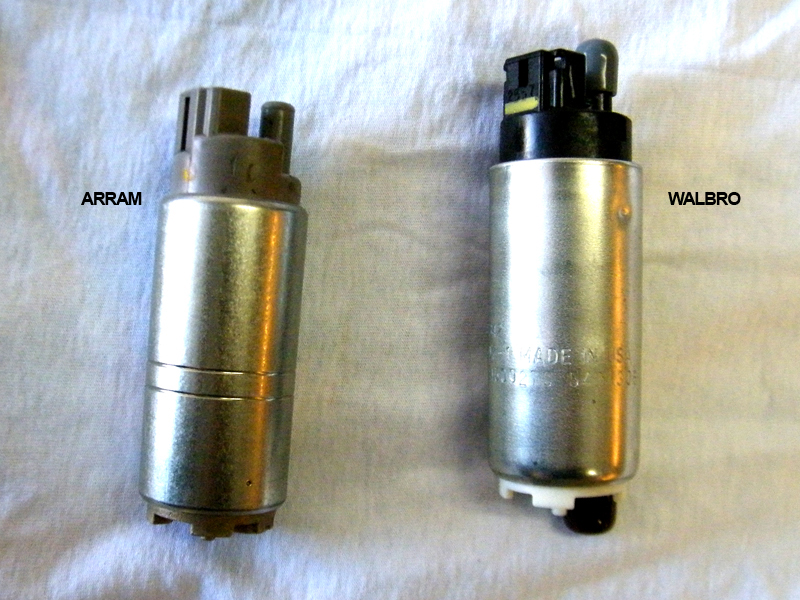

The pump motor is a ~115 lph (nominal) unit made by Arram. When current is applied, it draws fuel in from its pick-up port on the bottom through a plastic filter "sock" that blocks larger particles of crud from entering the fuel system. The fuel is discharged from the upper port under pressure.
Pressure and flow are, of course, inversely proportional, so the volume of fuel that is moved by the pump is a function of the pressure developed after the pump. This pressure is regulated by the main filter and integral fuel pressure regulator, into which the pumps output is sent.
The main filter and integral fuel pressure regulator has three ports: the inlet, the outlet and the pressure regulator discharge.
Fuel is pumped into the main filter assembly and exits the discharge at a rate determined by the integral pressure regulator (about 60 PSI).
When the pressure inside the filter exceeds the regulator setting, fuel is sent back to the fuel bowl via the regulator discharge and siphon assembly.
Fuel passes through a venturi on its way back to the bowl, generating suction on the siphon tube fitting. If excess pressure is generated by the small venturi orifice, it is bled off through a spring-loaded pop-off valve on the top of the assembly.

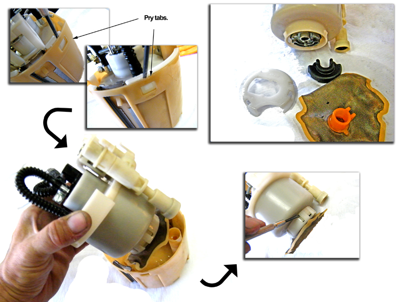

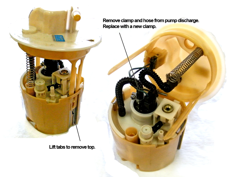

Simply modify the siphon assembly for greater flow and install a high-output pump motor.
The Walbro 255 lph pump fits into the OE housing perfectly, has the correct inlet and outlet, the same electrical connector and will provide enough flow and pressure for over 500 HP while still operating the siphon at all times.
Just dismantle the OE housing, replace the pump with the Walbro unit and it is ready to go. You will need a new "O" ring for the top of the pump that is about 1/2 the thickness of the OE ring. They can be had a Ace hardware for about 30 cents.
To increase flow through the siphon, just drill the venturi orifice out to 1/8" through the fuel return outlet (you should only do this with the upgraded pump and it MUST be done with the Walbro to avoid blowing open the pop-off valve at all times, reducing flow and cavitation of the pump assembly) and reinstall.
The Walbro pump can be had for about $90. Just be sure you get a real Walbro - there are quite a few Chinese copies out there that are horrible. Be sure to only purchase from a reputable distributor.
