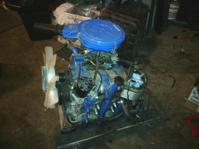

12A Engine Swap
So I've decided to abandon the GSL-SE 13B engine and swap to this...
I found this 12A engine in a pull yard a few month's ago in an earlier-model FB that was apparently junked because its differential exploded. This 12A has obviously been rebuilt, and the irons are painted the same Mazda blue that my other 12A was in my RX3. A sign from the rotary gods??? ...Of course it is!
As far as I can tell this 12A isn't ported, so I am going to pull it apart to be sure it's worth using and bridgeport it. I'll be using a Weber with this manifold... (Thanks Whizbang!)
And once this 12A is ready it's going to be mounted to this FC subframe custom-fitted to my FB. Along with FC rack-and-pinion steering, front suspension/struts, and 4-piston brakes.

I'd appreciate any help you had to offer. Just curious, with your car did you choose to go with the 12A transmission because of the better ratio's? Or did you consider adapting a stronger 13B transmission on it?
Some more pics of the 12A
200whp is my goal with this 12A on a streetable tune. I don't think a 12A could easily do much better then that, but a 13B could. I know the most powerful bridgeported 13B I ever heard of made 355hp! 0_0 *

truth be told the 12a and the 13b transmissions are both M-type. there is no difference in durability. Not until you move up to the R type (turbo transmission) Mine is the 12a case, with miata gears. Which was in my old rally car for a couple years without issue.
