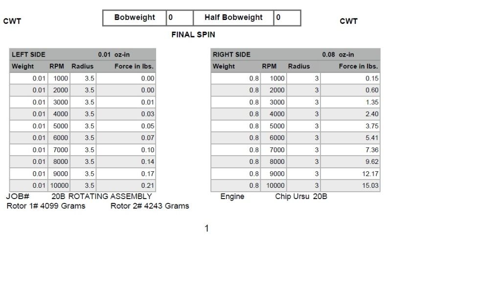

Originally Posted by 88turboii View Post
awesome build, looks like top notch work. did you get a weight on the rotors after the milling?
Thanks a bunch man!! I really can't take any true credit for the quality of the build though, it would have been the same old crapshoot from the same old crooks if I didn't have people like Brian around to make build suggestions (and actually do the labor) and the different shops (like Chip) to take care of making all the pieces to my little puzzle turn out perfect!!! I'm just the thankful owner
Here is the complete blueprinting sheet I got from Chip when he was finished with my rotors:
Here is the link to what Mazdatrix holds each generations rotor to weigh in at: http://www.mazdatrix.com/faq/rotorwgt.htm
(note: FD rotors weigh 4328g (9.54lb), the S4 N/A rotors weigh 4553g (10.04lb), and mine weigh in at 4099g and 4243g!! Happy dance!!)

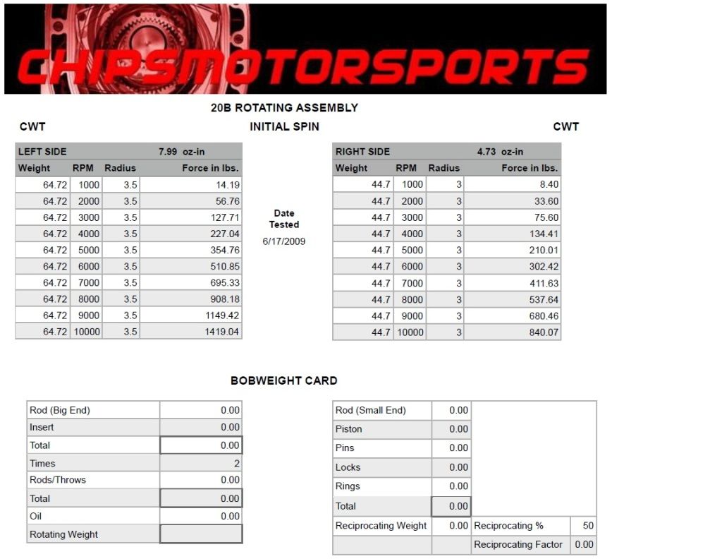

Side note, why does your balance sheet say 20B and have a date of 6/17/09? It looks like that was his balance?

I think the -10 filter to further reduce any pressure drop.
Honestly that's a good question on the date and why it says 20B. I really don't think this is Chips 20B though.
