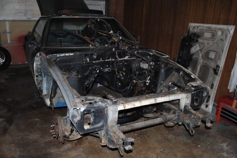

So, this car ain't going to make it to DGRR this year.
Got back at it today after something like 2 weeks of not touching it.
Still going backwards in the progress.

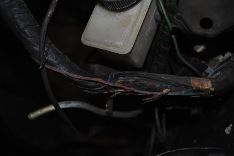

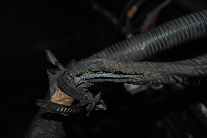

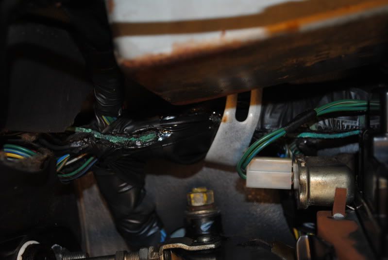

The wiring harness is a mess.
There are some aftermarket wires mixed in, spots where a wire had too much current running through it and burned through, and corrosion.
Some of the damaged spots in it.
This is under the dash.
A few days ago I downloaded the wiring diagram from "foxed.ca" (rx7 manuals). I can't get to the site right now for some reason, but there are links to the site in various threads on RCC.
Eventually I'll be going through and repairing the wiring.

i ran into the same problem when I had my SA figured out it was the main power cable going to the starter that had bin shorting out on the chassy and overheating all the wiring in turn melting the whole bundle together going throu the fire wall making the headlights blink when you turned a turn signal on.

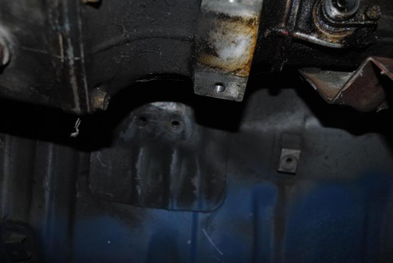

Deciding where to mount the engine & trans. Issues.

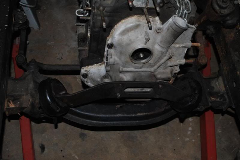

So getting back to this thing. And to add to the confusion. lol.

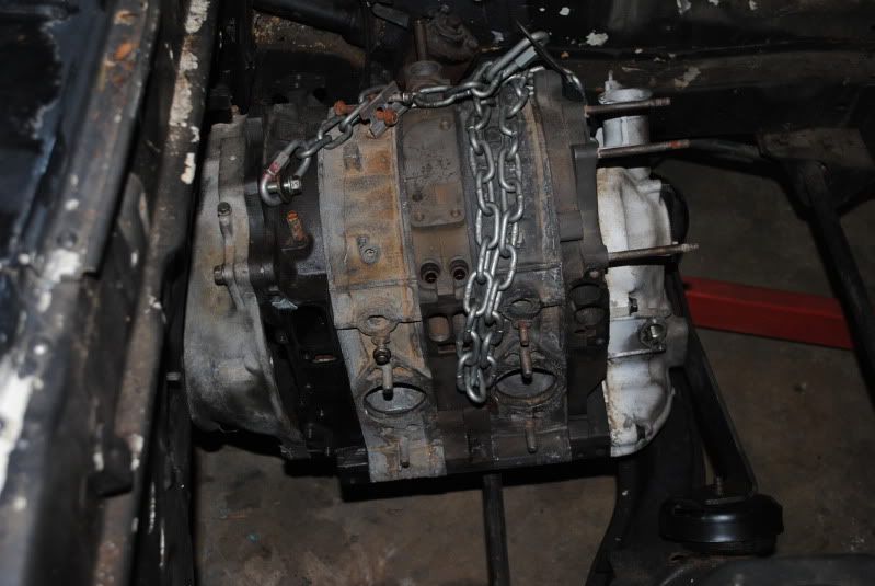

Ive got a dummy engine bolted in the car using the front cover mount, and a 13b trans bolted up to it held in place by a jack-stand.
My 1st question is: Dose this look right? Is that the way the mount goes?
But the answer to that question probably doesn't matter because for one thing, I plan to fabricate some engine mounting points for a 13b, and also because the way the trans doesn't line up the way I thought it would.
This is the way the trans mounting location looks.
The left side of the picture is toward the front of the car.
Is this right?
I have a junk 12a trans for reference. And the trans mount holes are about the same location as the holes on the 13b. 21&1/2 to 22 inches from the front of the trans to the mounting holes.
Similar dimensions that are the same on both transmissions are: Front of trans to output-shaft = 32"
The only thing different is the shifter location.

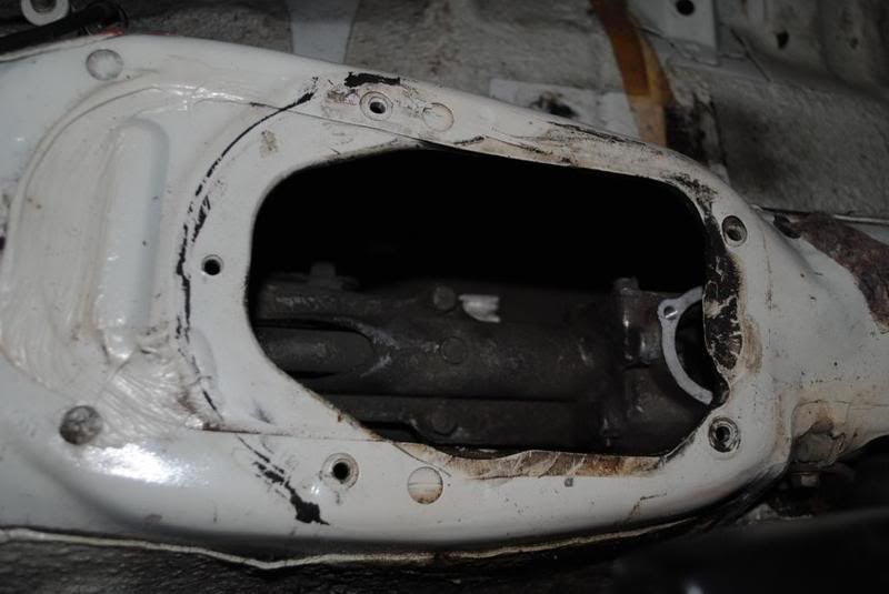

From the front of trans to the end of the shifter socket: On the 13b = 34", the 12a = 33".
Picture of the shifter hole.
I kinda knew that the shifter location would be off. But I thought that the trans mounting location would line up.
This is the engine location with that mount. Looks like a good location.
So I got to figure out where i want this thing and what to do about mounting locations.
I want to fabricate engine mounts for a 13b.
I thought I could use / want to use the stock location for the trans.

My experience is from putting in a NA 87 13B and transmission.
The 13B will sit a little farther forward than the 12A (13B is longer) if you use the stock transmission mount location. Which means either modifying your existing mount or buying a mount from Racing Beat.
The FB drivehaft should work with the FC trans in the stock location (mine did), FC won't as it's too short. I'm unsure why your driveshaft does not bolt up to the diff flange. I thought the bolt pattern was the same on the FBs, but evidently not. I'll have to go check my swap diff now.
You'll want to use the GSL-SE 13B oil pan and pickup so it will clear the steering arms. The stock trans mount will push the FC trans quite high in the tunnel so check your driveline angles. I had to do a lot of trimming and modifying to get the trans to sit where I wanted.
Unless you plan to have the car down for a LOONG time the independent rear swap is not worth it. The GSL-SE diff is supposed to be good to around 350-400 hp. The early (79-83) open diffs are a lot weaker though and as mentioned above the 84-85 axles have the better large bearings. You can get the 5 lug conversion axles through Moser for the big bearing rears.
The FC front subframe can be adapted to the FB with some work, others have done this quite a few times. Not legal for racing classes though. If you go that route the FC mounts, oil pan, and front cover should work, the trans mount location may work, depending on where you place the front subframe. If you change the trans mount location you will need to use a custom length driveshaft.
Using the FC radiator will also take a little work to get it to fit right. I do not know if the 12A radiator will be sufficient. I didn't want to chance it, so swapped everything over. Perhaps someone else has had experience with this.
Just sharing my experience with this swap.
