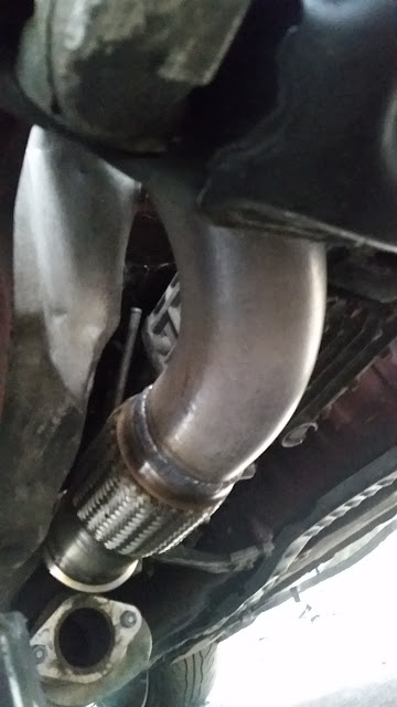

Fabbed up a 4" downpipe. Still need to add O2 bungs.

Old 12-28-2015, 11:22 PM   #177
chibikougan
chibikougan's Avatar
Location: Great Falls
Posts: 1,258
High Precision Tato Cannon?
Old 12-29-2015, 08:57 AM   #178
RXtacy
RXtacy's Avatar
Location: Rockville MD
Posts: 456
Indeed!
