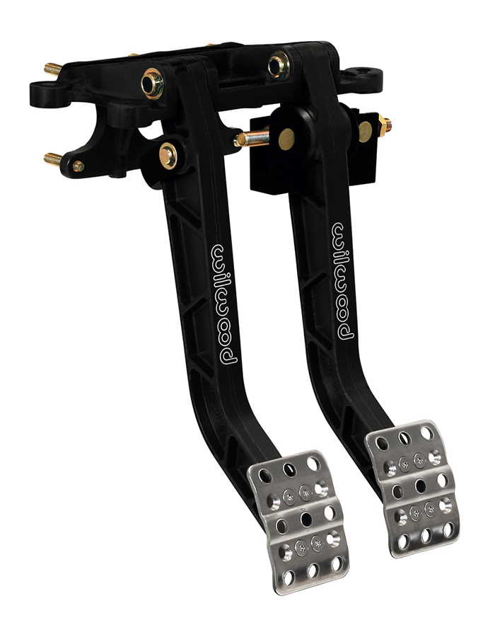

little more from today. starting to muck about with the brake pedal and whatnot for the wilwood masters too. Brake pedal is modified. Moved the attachment up some to get about a 6.5 pedal ratio versus the 4.77 factory. Need to do a little more welding and drilling to finish that off.

I think i have modified the oem pedal assembly enough to work! Pedal ratio is 6.5 ish (rounded). The lower attachment point has a nut welded to the back since you can actually get a bolt through, the bolt will be bolt from inside the car going out with a nut outside since you can't get the bolt passed the reservoir inlet. I need to prime and paint the assembly and then work on the firewall stuff.
