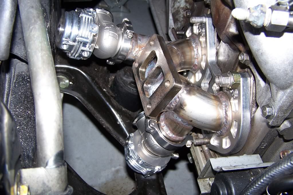

Do you have pics of these things? LOL!! I'm REALLY interested in the dual WG turbo manifold though. I've been wanting to do the EXACT same thing and I'd like to see what's possible. Are the runners equal length? What size WG are you using?

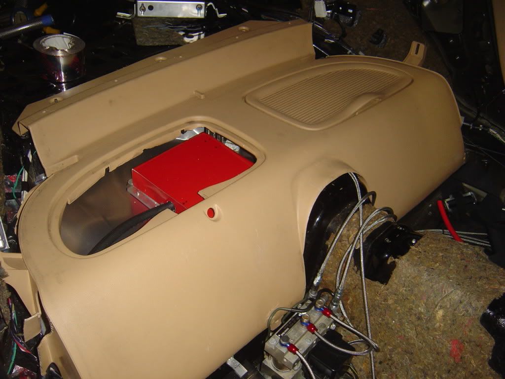

Thanks for the interest. I will have to dig up some pictures on the ABS relocation. Here is a picture of the tank install with the ABS unit next to it. I mounted the ABS unit behind the passenger seat next to the tunnel. Also I pulled the ABS ECU from the Left rear and relocated it where the rear right speaker was located. I eliminated all the wiring from the driver side all the way around to the passenger side, the ABS ECU wiring harness basically circled the vehicle. I only had to splice about 10 wires to the unit itself. It was not as difficult as I thought it was.
I will dig up some more pictures, these are not that great for the ABS relocation. Also I used the -3AN speed flex lines with aluminum banjos from the unit all the way to each wheel.
Goals:
Weight reduction, relocate weight to the lightest corner of the car.
ABS ECU = 2.2 lbs
ABS unit = 14 lbs
relocated to right rear corner of car.
Removed 7 lbs of steel fittings, tees, brackets from the stock brake lines.
I have not had any issues with brakes, 2 seasons of racing so far. Well except for the master cylinder failing at NSS last year.

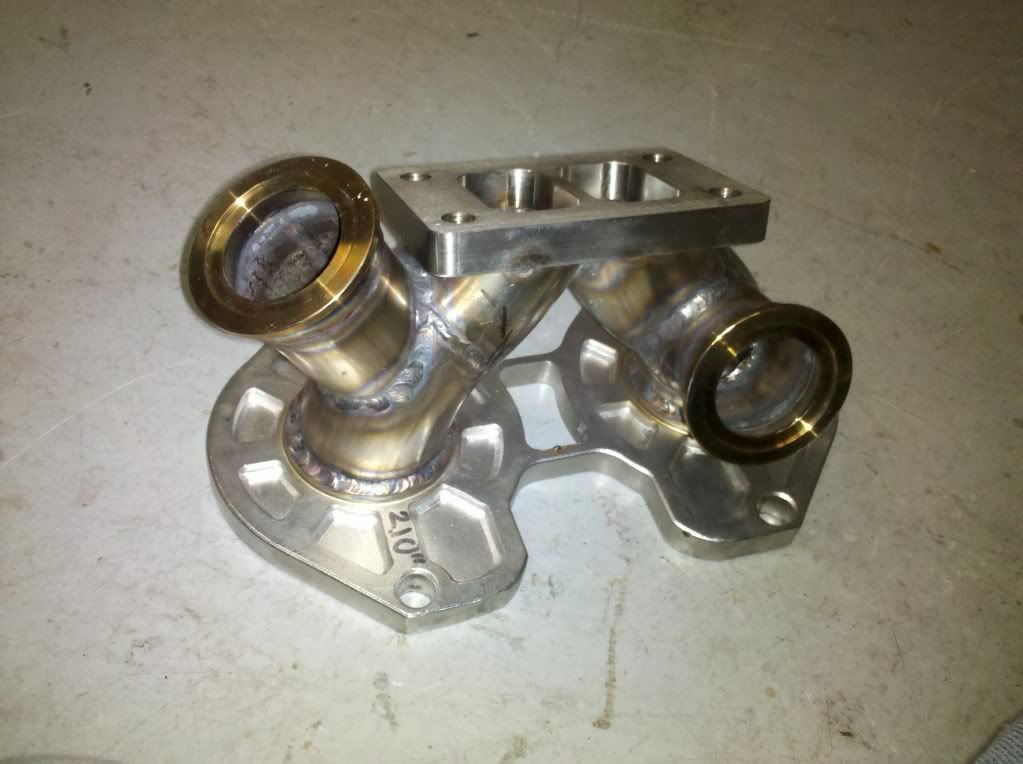

Pictures of the manifold build

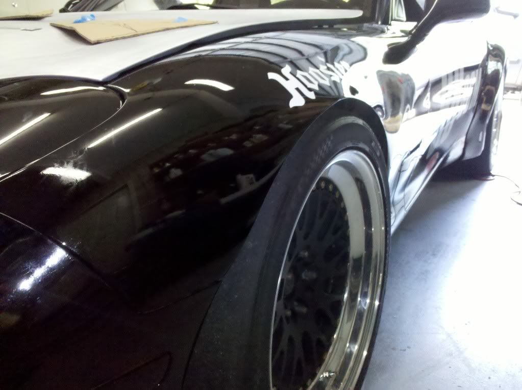

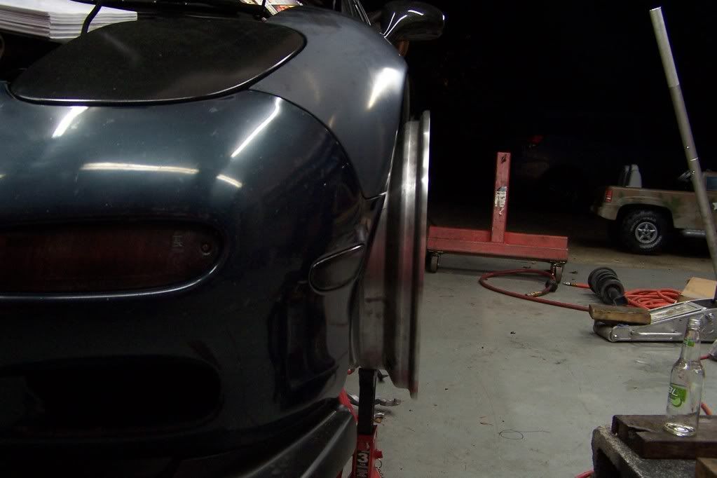

I could not find a decent aftermarket fender to my liking so I had someone make some for me. The metal is really thin as you say but the English wheel does a nice job stretching the metal out. The only issue with this set up was cost. It really hurt the pocket.. The pictures do not do the fenders justice. They look stock. But try fitting 315's on 11" wide wheels with stock fenders.

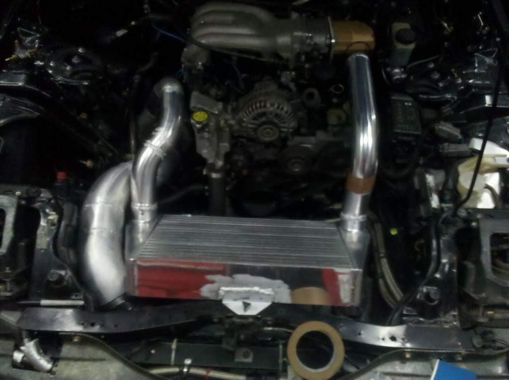

V-mount stuff,

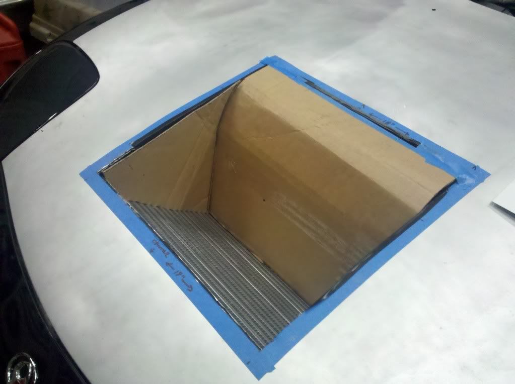

HOOD, stripped of paint and cutting hole for IC vent.

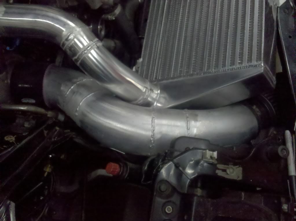

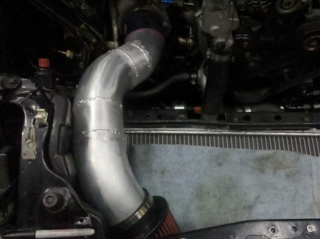

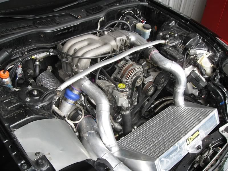

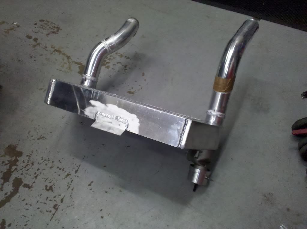

Intercooler, core is 18x12x2.5, I also welded the IC pipes so I would eliminate hoses blowing off at a race.
4" CAI
AFCO dual pass radiator. This radiator is split in the center. The entry is on the passenger side and the water flows over and up to the driver side to exit. I also used the stock fans on the bottom.

I love those short runners. SUPER short. Do you have any problems with oil drainage from the turbo to the pan? Do you still use the front oil drain hole? I have two EGT bungs I'd like to weld in too, looks like there might be room on top of the runners. Not sure if it would be easy to get in there around the turbo to install them though. Did you get that exhaust flange from Racing Beat? Did you use 304 or 321 for that runner? I can't believe you were able to route the WG dump back into the exhaust too, that's awesome. I have so much trouble putting mine back together with just one WG as it is. I'd love to do this though and cut down on noise. And I love the 4" DP, but I don't want to get rid of the resonated MP and GReddy Ti, so I'm not sure a 4" DP alone would be very beneficial. Are you running water/coolant to those wastegates? If so, where did you route them from and back to? I bought the same ones and I'm trying to figure out where to source the water from.

Originally Posted by josh18_2k View Post
soooo you're not allowed to duct after the radiator, but intercooler is OK? sounds like that rule is broken.. (I'm XP btw, same ducting rules)
Good point but I do not have any "ducts" in or on my car. Also the cardboard was just used as a template (only good picture I had). The final design is 4 inches away from the IC. This means that the hood has a "vent". Rules say hoods are free. Also my hood is vented less than most after market bling bling ones. Thanks for the concern.

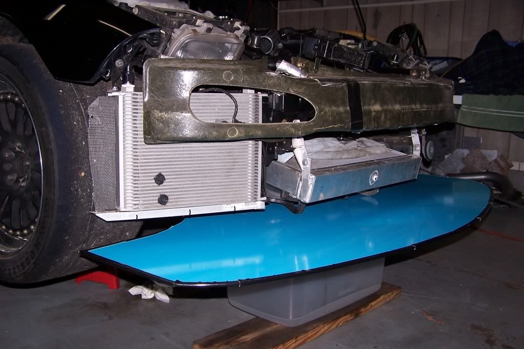

Do you have fans mounted to the back of your oil coolers? Yes one 10" fan.
Do you have any problems with oil drainage from the turbo to the pan? Not at all, and I am using the front drain also. I believe I use -10AN on that one.
321 SS from Burns stainless. everything is 321 up to the 4". The 4" exhaust is 409 and it starts at about the rear of the transmission.
Are you running water/coolant to those wastegates? Not at this time. This is one of my next season projects because I have over heated the rear diaphragm twice at a race limiting my boost to 15psi which = slow. Also I might have to relocate the WG since it is close to the DP.
It was not easy, also in SSM we cannot run open WG's. All exhaust must exit rearward of the rear axles.
What brand IC core is that? Did you do the same size piping on both ends of the IC? the IC is a cheap ebay core, I was experimenting and did not want to spend big bucks on a IC if it did not work. Also it is 2.5" in and out. I think I have pretty good response if not too much sometimes. Bell IC cores would be my first choice too.

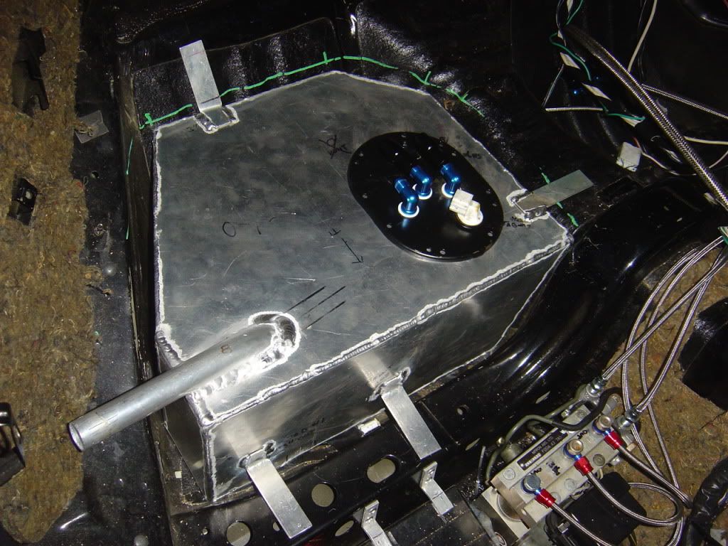

The first pic is the custom surge/anti slosh tank installed in the 5 gallon cell. It basically fills itself with the return. If the tank fills to the top I have a drain hole on the top of the tank to drain excess out. The little red thing on the right is the one way valve which is mounted on the opposite side of the picture. I do not have a LP pump feeding this but I can run very low on fuel and still not starve. I have estimated by weight that I have been down to 2 gallons with no issues. Also I have mounted the stock low gas warning light inside the surge tank. If the light comes on that means the surge tank is below half way ( it has never came on). Oh! did I mention that my stock sending unit is still operational.

The best thing about this fuel pump set up is that the stock plastic cover fits over it and hides everything. I removed it for the picture but I run the plastic to protect the pump and filters from rocks and such.
