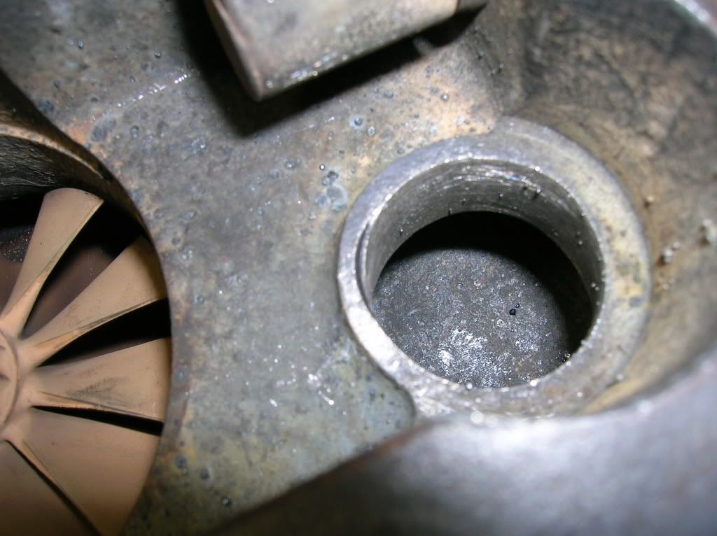

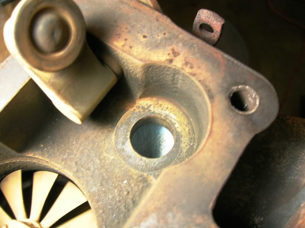

Ported Wastegate.

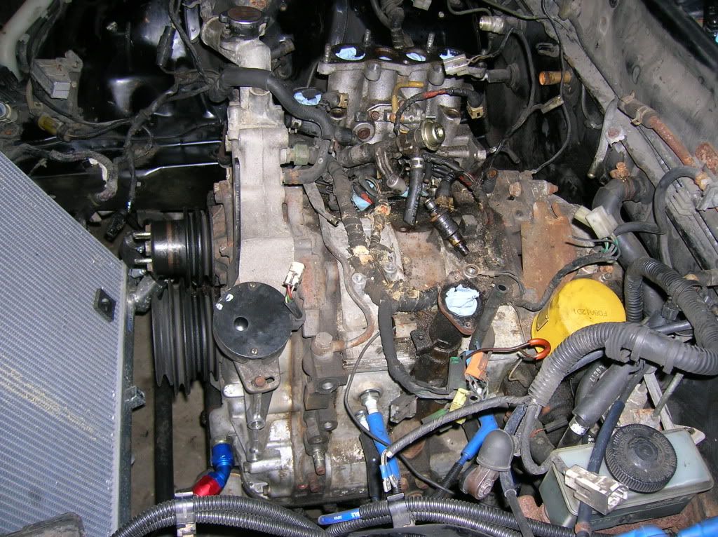

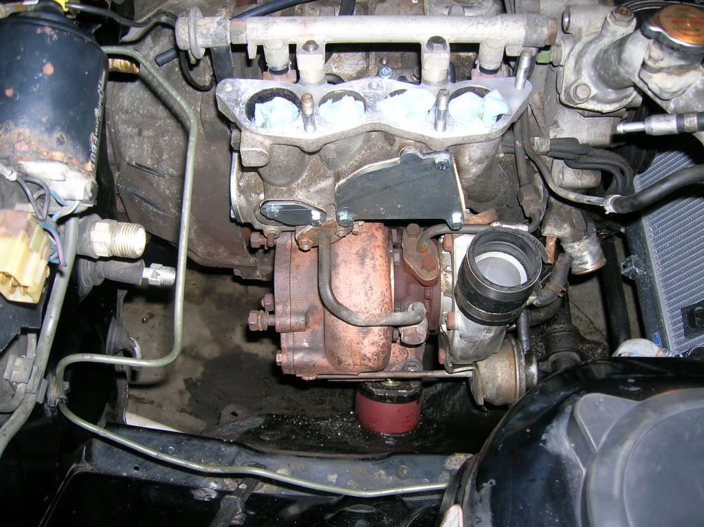

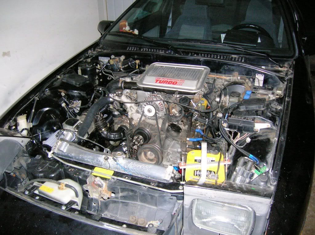

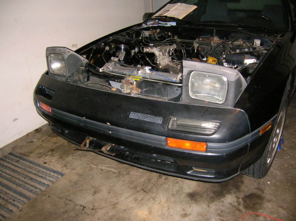

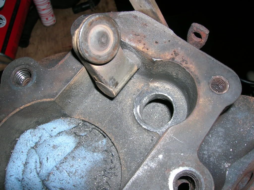

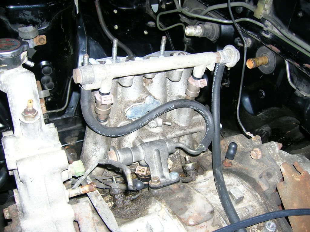

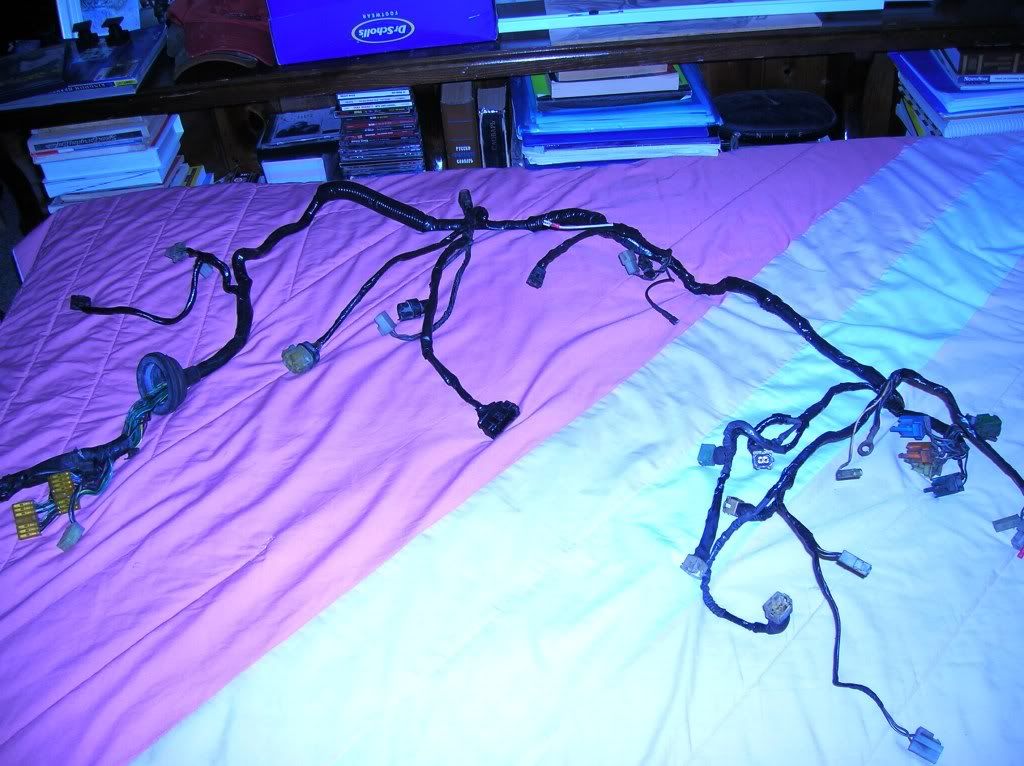

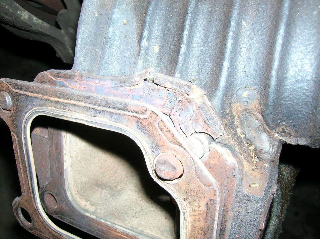

Here:
Removing emissions, porting the turbocharger, and rewrapping the harness:
The idiot that replaced the turbocharger left the old gasket on there, and just slapped the new one over it, Doh!

Yeah, it's alright. I just got a hold of a die grinder for a few days, so I'm going to REALLY port the wastegate now, not just this dremel bullsh*t....
