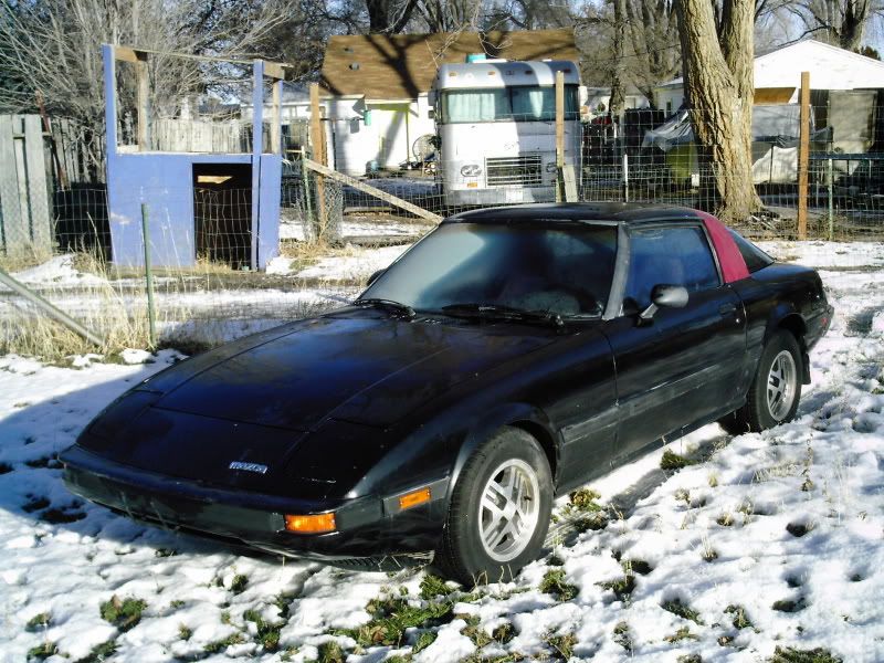

So i finally brought home my chassis for my rally project. 1982 GS, automatic with a bad wiring harness. This is soo little rust on this car its crazy, i love the northwest. Also has a glass sunroof that will find its way to the silver Rx7. Once the weather warms up a bit ill be tearing into this thing.

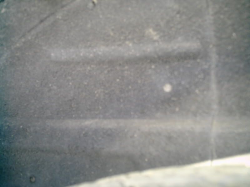

Old 06-24-2010, 11:55 PM   #15
so much stitch welding...
