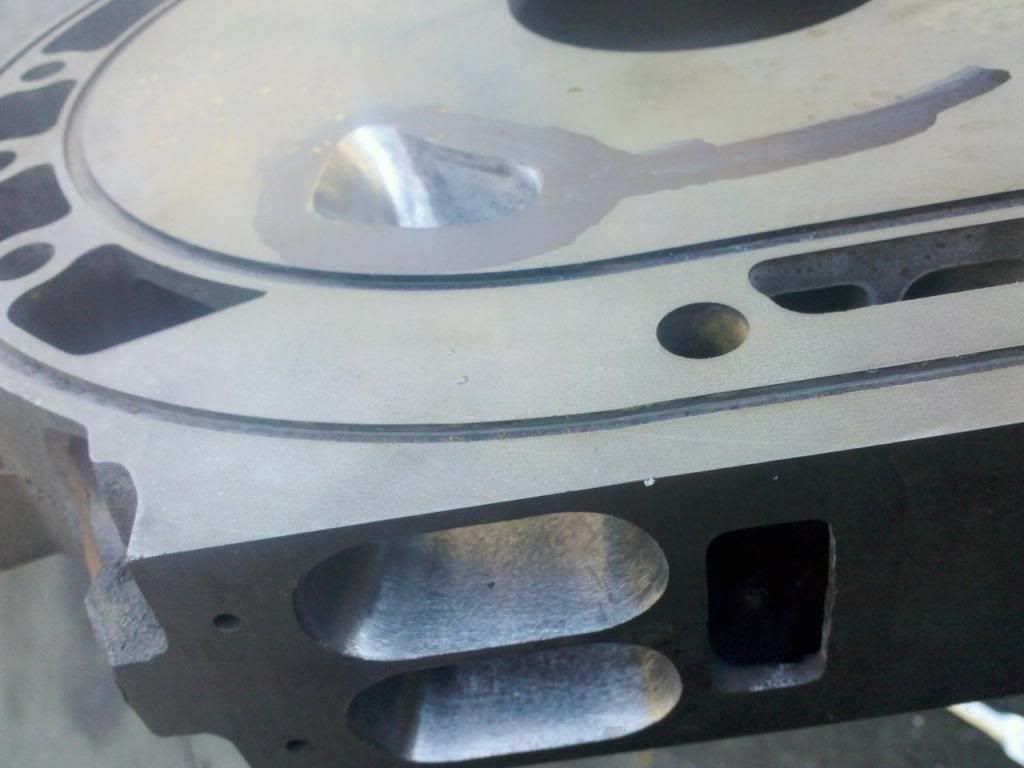

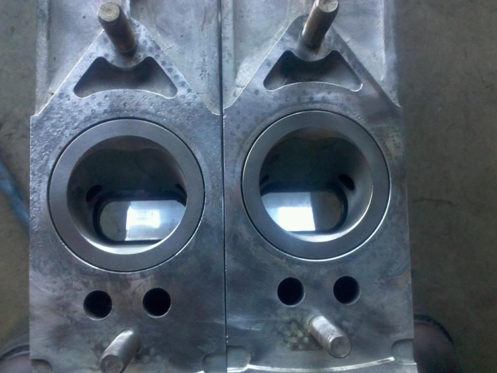

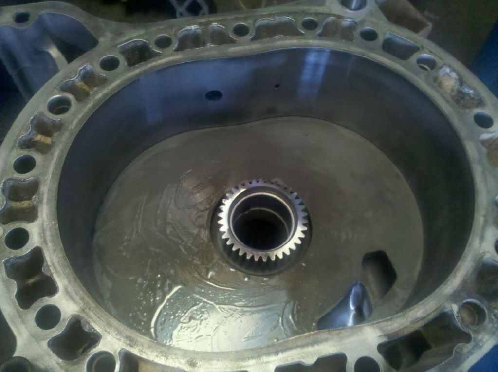

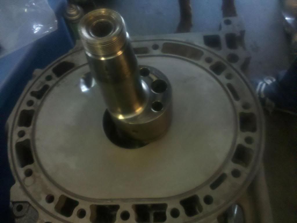

Well my FC has been my first car, and like every RX7 owner you have a love hate relationship with your car. I blew my engine during spring break of my freshman year of college.
After much patience I finally sent my engine to Lucky7Racing in El Monte California to get rebuilt.
Here are a couple of pictures of my series 5 N/A engine as it gets turbo sleeves installed and a medium street ported.

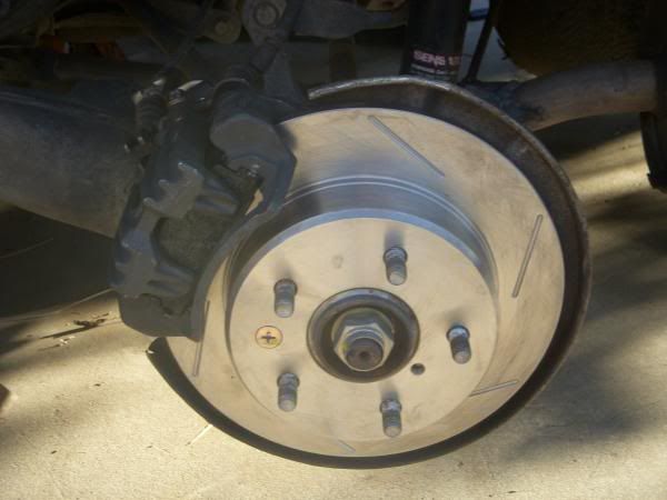

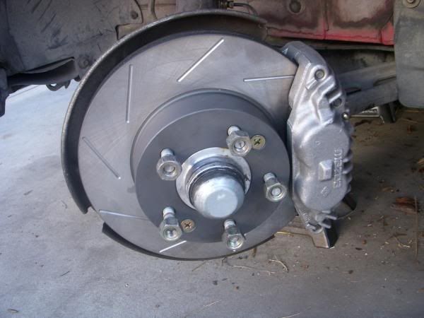

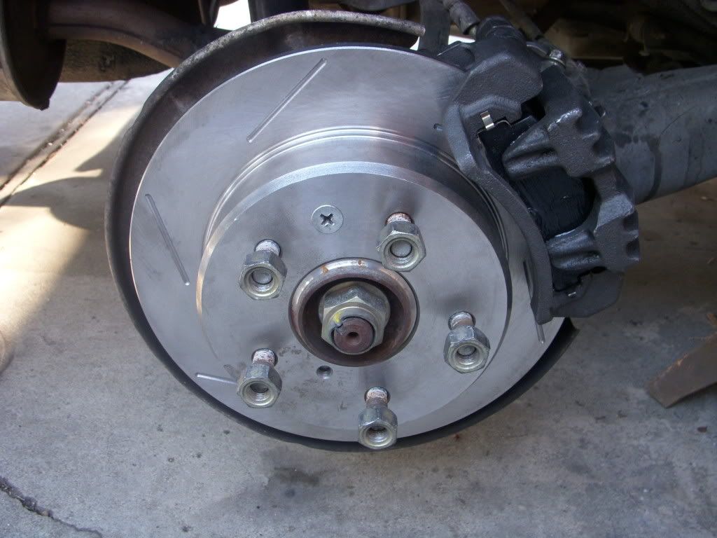

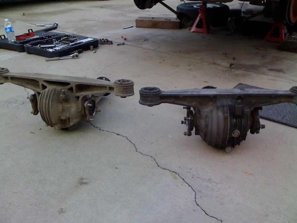

A couple of pictures of my brakes before my engine took a dump.
I upgraded from the 1 pot GTU calipers to the 4 piston calipers from a series 5 vert model. Had them rebuilt, same with the rear.
Also came up on an actual GTUs LSD unit for really cheap.
(The LSD unit is on the right)

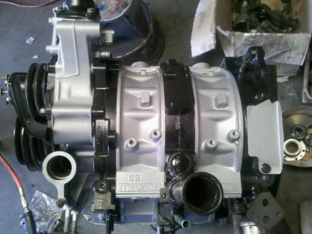

Gabriel82 01-27-2011 11:16 PM
More progress done on the engine =]
http://i469.photobucket.com/albums/r...6165142549.jpg
http://i469.photobucket.com/albums/r.../Unnamed-1.jpg
http://i469.photobucket.com/albums/r...64636099-1.jpg
http://i469.photobucket.com/albums/r...6164899771.jpg
http://i469.photobucket.com/albums/r...og/sdftemp.jpg
http://i469.photobucket.com/albums/r...og/sdrtemp.jpg
http://i469.photobucket.com/albums/r...6175111420.jpg
http://i469.photobucket.com/albums/r...6176613888.jpg
http://i469.photobucket.com/albums/r...6177568212.jpg
http://i469.photobucket.com/albums/r...6179170159.jpg

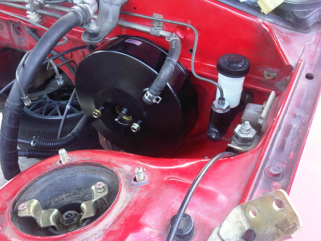

So my dad has been rebuilding brake boosters and brake master cylinders for a very long time. He finally taught me how to do it. Here is a picture of the new rebuilt booster. I also changed out the clutch master cylinder while I was at it.

the ports look good. i also like what you did with the brakes. how involved is it to rebuild a brake booster?
good job overall.
Gabriel82 01-28-2011 03:28 AM
Hmmmm well my dad has a lot of inventory so he had the replacements for the diaphragms inside. Basically you open up the booster take out the diaphragms, change them out, check out the seals, re-grease the seals and the hub. Paint the shells. It's a little tricky, but luckily my dad has decades of experience so he guided me through the process.

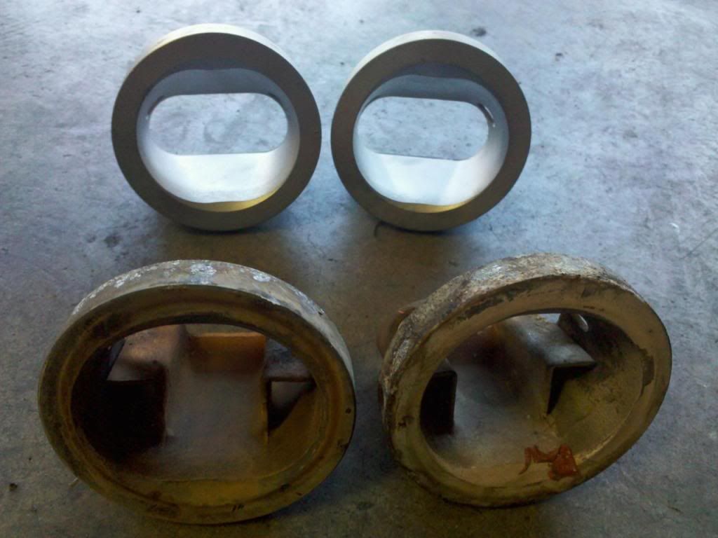

Gabriel82 02-01-2011 05:54 PM

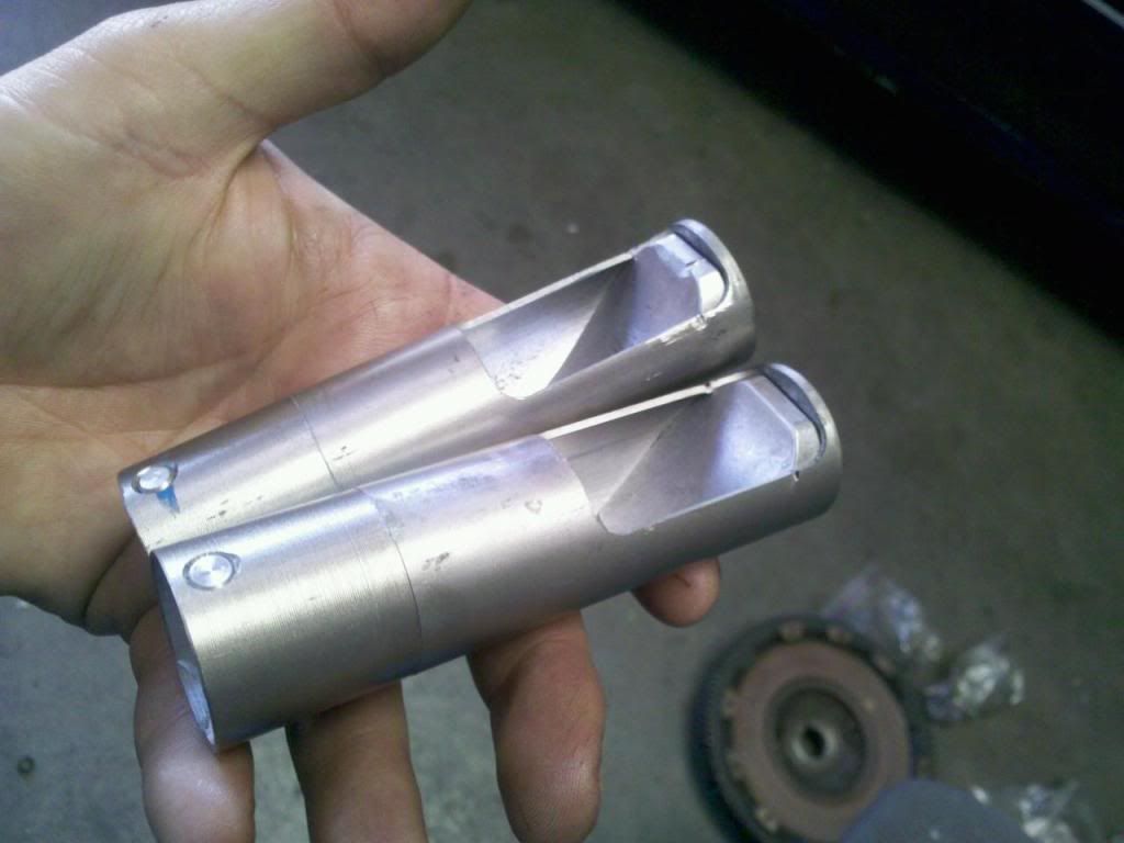

Engine is almost done just needs the intake manifold, block off plates, etc.
http://i469.photobucket.com/albums/r...6517427034.jpg
Pineapple Racing Intake Inserts
http://i469.photobucket.com/albums/r...6585119340.jpg
