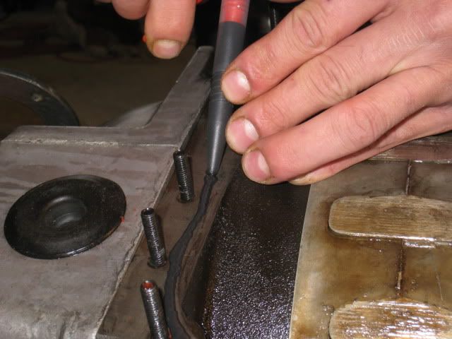

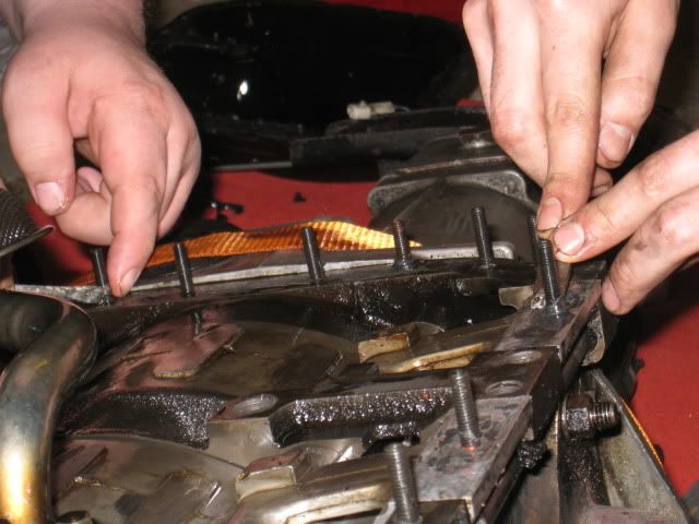

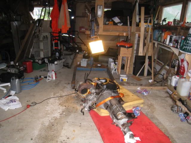

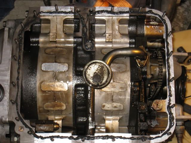

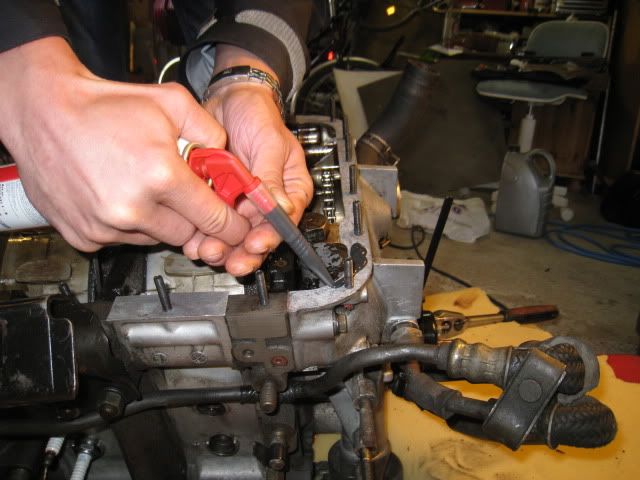

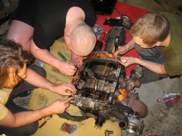

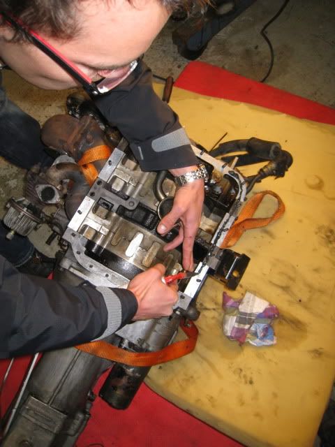

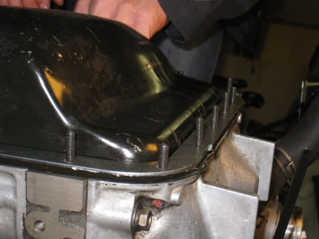

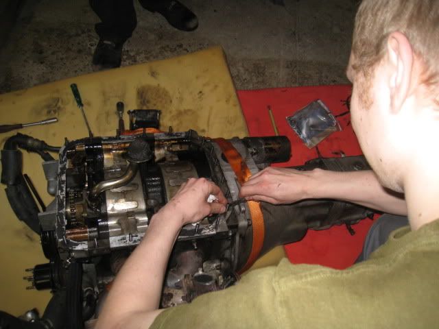

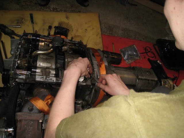

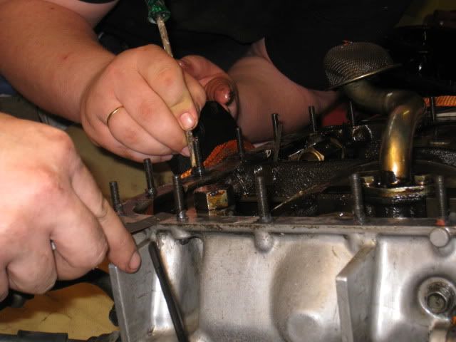

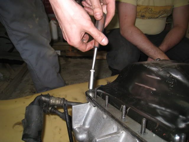

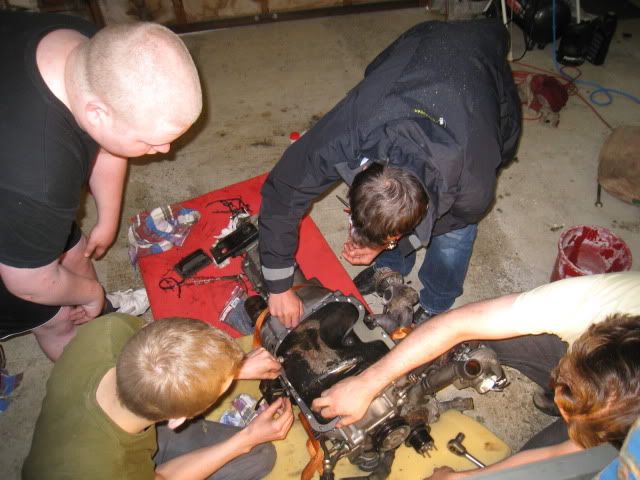

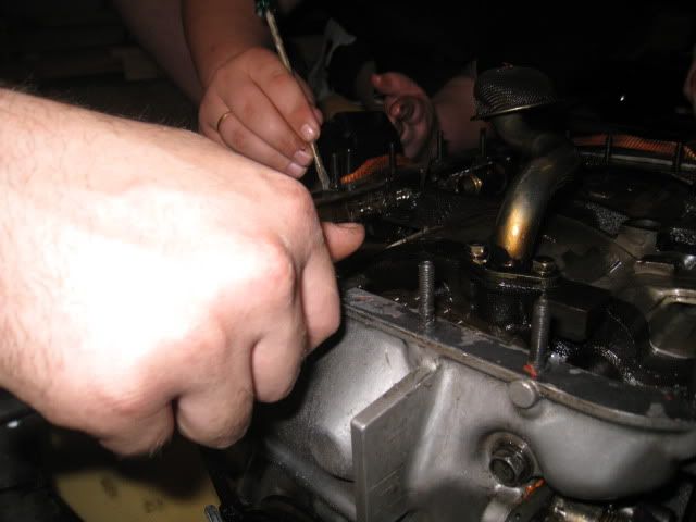

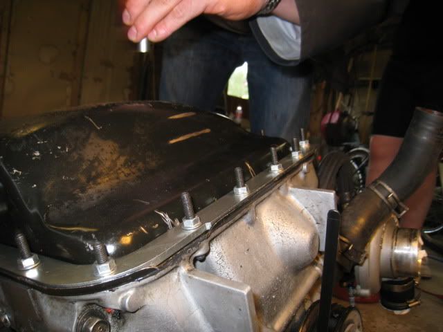

And finally fixed the oil leak, put in a new gasket and a oil pan brace with studs, :D
http://i71.photobucket.com/albums/i1...7/IMG_1504.jpg
http://i71.photobucket.com/albums/i1...7/IMG_1505.jpg
http://i71.photobucket.com/albums/i1...7/IMG_1506.jpg
http://i71.photobucket.com/albums/i1...7/IMG_1507.jpg

Thumper 05-24-2011 06:20 AM
Looks good, was it a pain to put in that oil pan brace with the engine installed? I have one that i still need to install.
Pettersen 05-24-2011 06:51 AM
Well i was in a garage with a garage pit, and i had help. But no it wasn't to difficult, just as long as you support the engine properly so it doesn't move when you take off the engine mount. The first time i had a jack underneath but the engine still shifted enough to make it a pita to get the engine mount back on, and with the engine further down the studs where almost impossible to get in some places, so i used some 2"4" and supported the engine from the top and it didn't move at all.
You can use an allen key on most of the studs, but on the front row i used two nuts thightened agains each other, and a little ratchet with and extender and a angle thingy(picture i don't know what it's called in english), it's a bit fiddly but it's doable.
Also a warning, it's probably not possible to get the oil pan on without scratching agaisnt the studs, so i had the sealent on the block, not the pan.

Pettersen 06-13-2011 03:02 AM
One week until trackweekend, and it turns out i have a oil leak, last time i changed the oil pan it didn't make a seal+ it looks like i have some other small leaks or sweatting that i need to tend to. I decided i need to take the engine out in order to get the leaks fixed properly, it's just to much oil slowly running down to the gasket surface, and im guessing that's the reason it leaks now.
http://i71.photobucket.com/albums/i1...1/IMG_1596.jpg
http://i71.photobucket.com/albums/i1...1/IMG_1597.jpg
http://i71.photobucket.com/albums/i1...1/IMG_1600.jpg
http://i71.photobucket.com/albums/i1...1/IMG_1601.jpg
http://i71.photobucket.com/albums/i1...1/IMG_1604.jpg
Pettersen 06-13-2011 02:11 PM
Ill just let the pictures speak for themselves.
http://i71.photobucket.com/albums/i1...1/IMG_1605.jpg
http://i71.photobucket.com/albums/i1...1/IMG_1606.jpg
http://i71.photobucket.com/albums/i1...1/IMG_1607.jpg
http://i71.photobucket.com/albums/i1...1/IMG_1608.jpg
http://i71.photobucket.com/albums/i1...1/IMG_1609.jpg
http://i71.photobucket.com/albums/i1...1/IMG_1610.jpg
http://i71.photobucket.com/albums/i1...1/IMG_1611.jpg
http://i71.photobucket.com/albums/i1...1/IMG_1612.jpg
http://i71.photobucket.com/albums/i1...1/IMG_1613.jpg
http://i71.photobucket.com/albums/i1...1/IMG_1614.jpg
http://i71.photobucket.com/albums/i1...1/IMG_1615.jpg
http://i71.photobucket.com/albums/i1...1/IMG_1616.jpg
http://i71.photobucket.com/albums/i1...1/IMG_1617.jpg
http://i71.photobucket.com/albums/i1...1/IMG_1618.jpg
http://i71.photobucket.com/albums/i1...1/IMG_1619.jpg
http://i71.photobucket.com/albums/i1...1/IMG_1620.jpg
http://i71.photobucket.com/albums/i1...1/IMG_1621.jpg
http://i71.photobucket.com/albums/i1...1/IMG_1622.jpg
http://i71.photobucket.com/albums/i1...1/IMG_1623.jpg
http://i71.photobucket.com/albums/i1...1/IMG_1624.jpg
http://i71.photobucket.com/albums/i1...1/IMG_1625.jpg
http://i71.photobucket.com/albums/i1...1/IMG_1626.jpg
http://i71.photobucket.com/albums/i1...1/IMG_1627.jpg
http://i71.photobucket.com/albums/i1...1/IMG_1628.jpg
http://i71.photobucket.com/albums/i1...1/IMG_1629.jpg
http://i71.photobucket.com/albums/i1...1/IMG_1630.jpg
http://i71.photobucket.com/albums/i1...1/IMG_1631.jpg
http://i71.photobucket.com/albums/i1...1/IMG_1634.jpg
http://i71.photobucket.com/albums/i1...1/IMG_1635.jpg
http://i71.photobucket.com/albums/i1...1/IMG_1636.jpg
