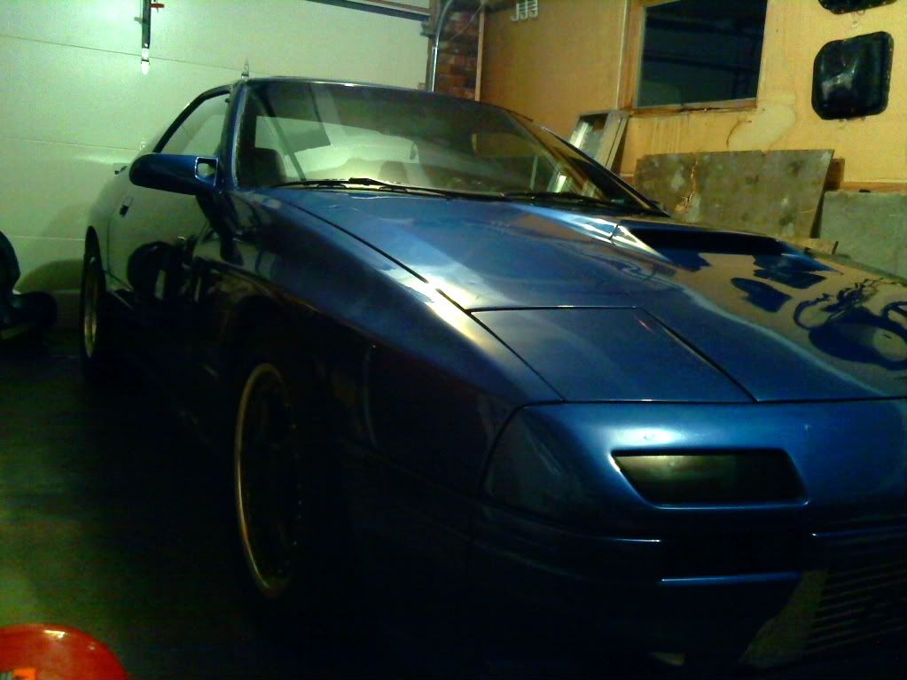

Gave her a wash and wax tonight. mnmmmmmmmm smooth
http://i721.photobucket.com/albums/w...9250920071.jpg

FC3S Murray 11-21-2009 12:30 PM
3 Attachment(s)
heat tape
TitaniumTT 11-21-2009 01:47 PM
Nice Sean! Thanks clean! Really clean.... I likey
