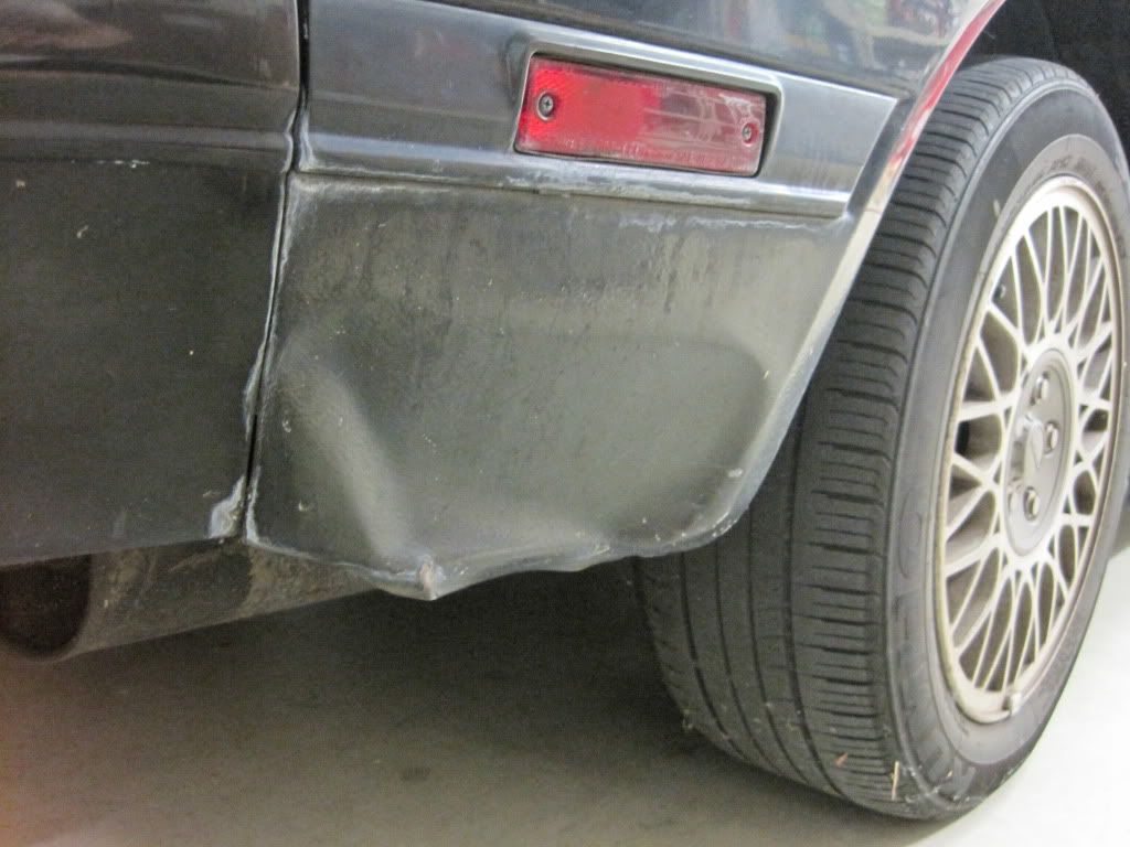

Hell nah, I used some ultra mega crazy 3M shit! I DID hammer and pull the dent out as much as I possibly could though, so it's not as thick as you might imagine... What we did was to pull the part under the line out first, and then go back and pull out the part above the line. After that, caved and paved the 3M stuff on, and used a wide sanding disk on a big orbital grinder to shape the panel.
Went over this with 3M again, and after that, used a long bladed air sander to shape it into what you see there. Now, after this, the panel still needs just a real thin layer of bondo and glazing putty to make it perfect, but the fiberglass shit took care of mostly everything really. Honestly, the hardest part was to shape the dip for the rear trim piece, that area got distorted really bad.

If you were able to make that damage look good, I should be okay with my major crinkle.
http://i189.photobucket.com/albums/z...4/IMG_0208.jpg
