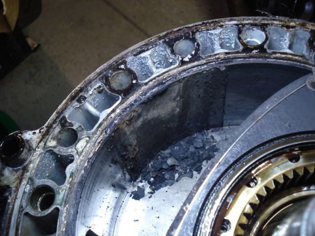

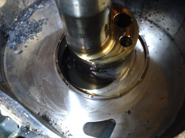

I was honestly expecting the carnage to be worse from your description on phone man! But yeah that bearing is TOAST! Housings look slightly worse than I anticipated.
I agree with those rotors being 3mm candidates. Although I have heard too that they seal worse than 2mm? I am not the expert here, sorry. |
Well, after taking a closer look at the housings last night, I believe it would be best to change the title of this thread from rebuilding engine to buying completely different engine LOL. There are small cracks next to each spark plug port. So I'm either looking for a good engine with low miles, large streetport, preferrably using the seals I'm looking for...or an engine that needs a rebuild that still has good usable parts.

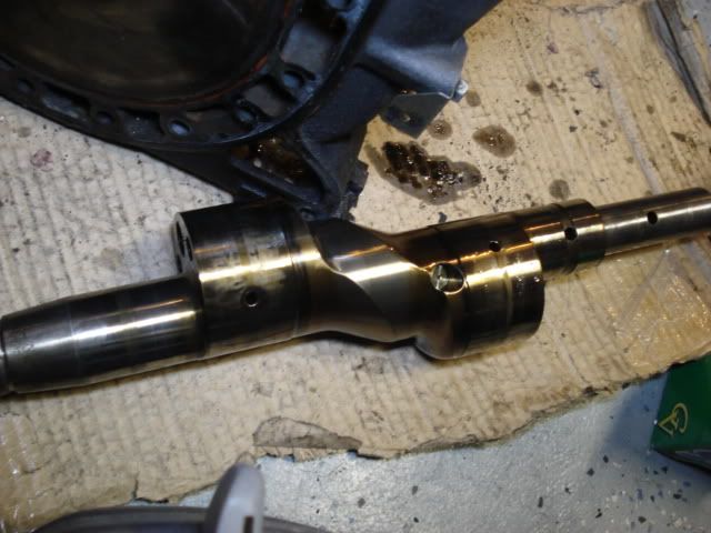

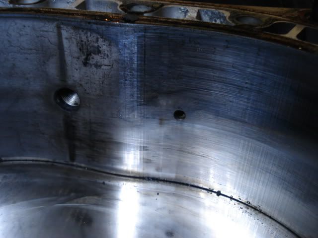

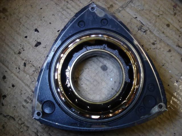

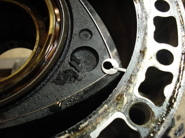

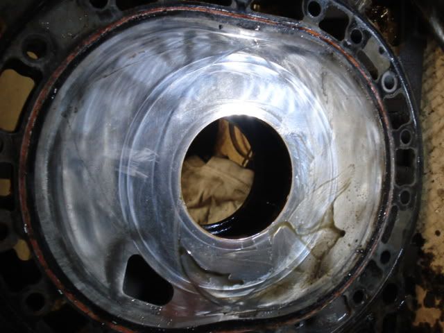

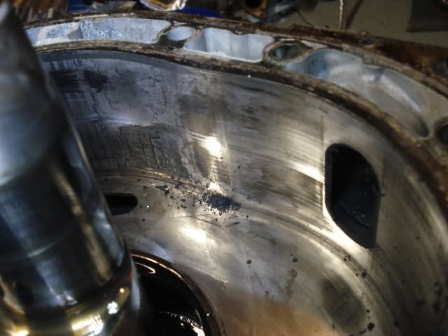

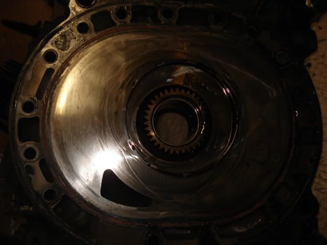

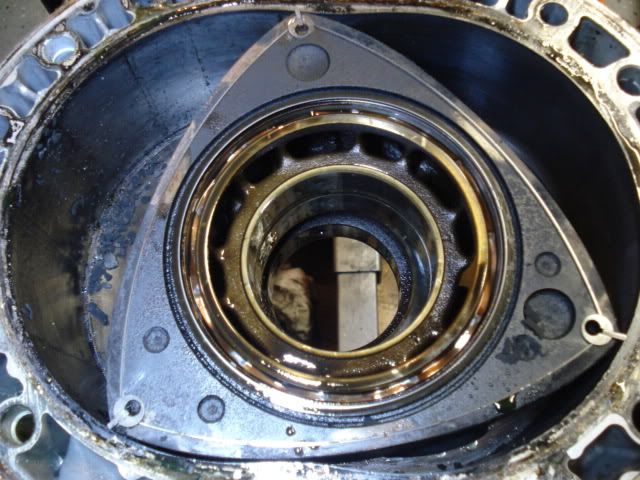

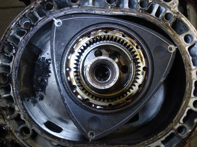

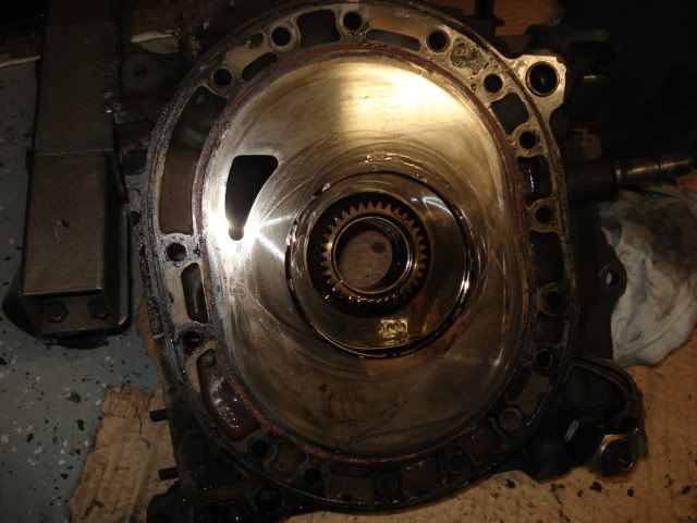

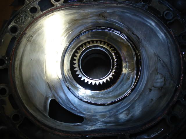

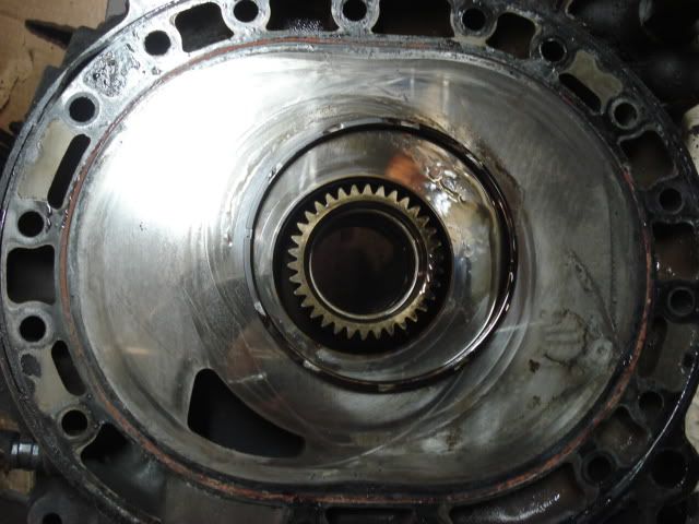

Engine #2 (original engine)

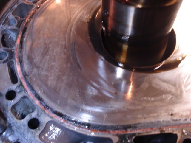

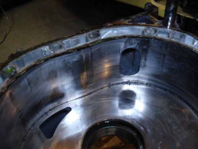

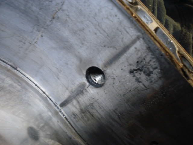

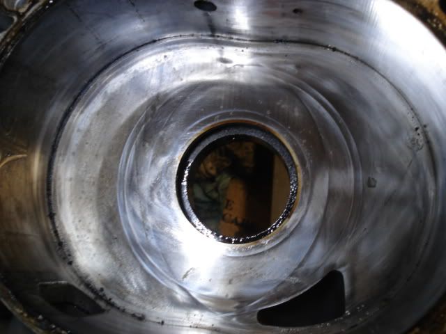

So I tore down the old engine tonight, the engine that was in the car when I bought it. HOLY CRAP this thing is almost flawless! It's unreal how nice it is. The irons are amazingly smooth, the housings have slight chatter marks and the front housing has a small crack next to the leading spark plug port. There was one rubber insert missing from one of the corner seals on one of the rotors. On each rotor one oil ring stuck to the iron as I removed the parts, not sure how much that means, if anything. Other than that this thing is amazing! I'm so happy haha.

Thanks! Good luck with your results too. Even though I have no idea what happened to this engine to make it go, I realize now that I'd much rather lose a coolant seal than an apex seal LOL.
I've been thinking about sending it to Goopy but the crack goes pretty deep so I doubt they'd be able to save it and I'm worried that their resurfacing might have the same effects of resurfacing an iron and not re-nitrading it, which is what I did to my irons and they are unusable now. Regardless I think the crack is too deep anyway and I'll need a new(er) housing. |
