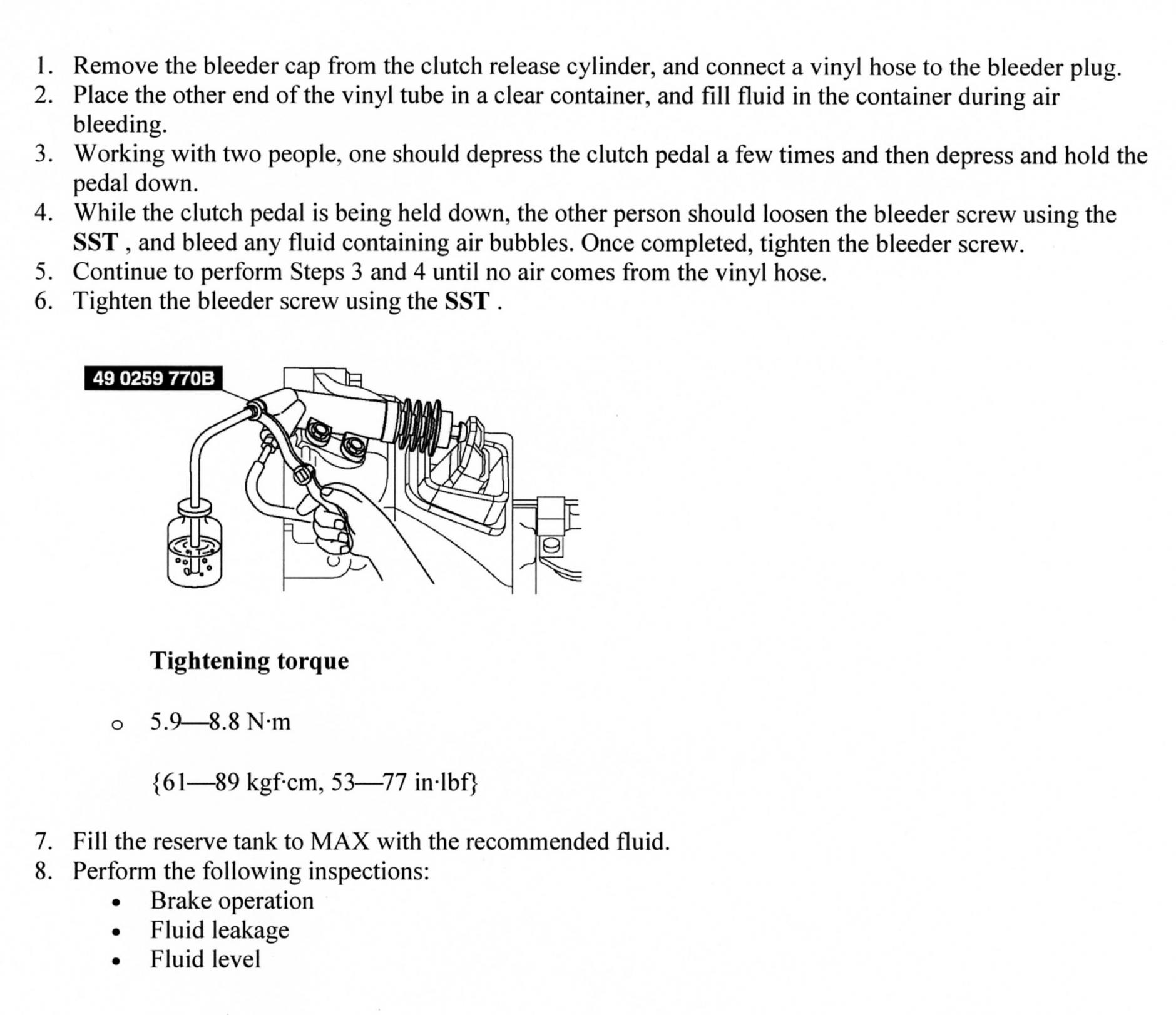

Anyone know how to repressurize the clutch peddle? That was all I lacked having everything reassembled last night.

What do you mean by "repressurize" the clutch pedal? you mean as in bleeding it out so it doesn't hit the floor instantly when you push on it? When I had to replace my clutch master cylinder I bled it out at the point were the line going to the slave cylinder connects, cause I didn't want to deal with the slave cylinder. However, if you had the whole thing apart, bleed it from the slave. below is a link to the factory service manual on that. The only thing I would add it to unbolt the slave from the transmission and the bracket holding the line, it will make the process MUCH easier.
http://www.rx8club.com/attachment.ph...8&d=1240398540

yea, I have to bleed the lines.

yep, thanks for those.. I printed them so I can resolve that tonight hopefully.
