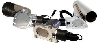

Vex, why not an electric cut out? Off the DP put the cut out. One 3 or 3.5 goes through a few baffeld mufflers to keep shit quiet, and the other heads off to a strait thru design? There's enough room under the FC to get 2 3" pipes there and the provisions are already there in the bumper. Why not?
vex 08-01-2010 10:11 PM
Originally Posted by TitaniumTT (Post 124976)
Whoops, thanks.
I don't have a db meter or I wold use it.
It does sound harsh, it's a $130 camera.
I'll grab the GoPro on saturday when I'm back
:rofl: As you can see, I hate that whole monster tip BS anyway. Those are ~3" tip I think? Summit Racing too.... I had a problem spending more on a tip than I spent on the cans... go figure right?

Originally Posted by sen2two (Post 125069)
Cut out is really the only way to have best of both worlds. But i wouldn't run it all the way back adding un-needed weight. Place the cut out right on or after the downpipe. No cost at all really. Just a spare 3" pipe with a flange. Another flange to block it off and 2 or 3 bolts. Done... would cost only about 10-15 bucks extra and will weight maybe 1lb. Only down fall is unbolting it, which takes all of 10 seconds...
would be more expensive, but could always get an electronic cut out. This would allow an easy change over on the go. I think QTP made nice cut outs.
